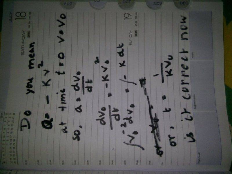

a= - kVo^2
Since a=dv/dt
So,
Vo/t = - kVo^2
or, t= - 1/(kVo)
or, t = 1/(kVo) , as time can't be negative.

... and, for d?
romiomustdie said:
a= - kVo^2
Since a=dv/dt
So,
Vo/t = - kVo^2
or, t= - 1/(kVo)
This solution to the differential equation is incorrect. The differential equation reads:
$$\frac{dV}{dt}=-kV^2$$
Note that there are V's on both sides of the equation. Do you know how to solve such an equation? If so, let's see.

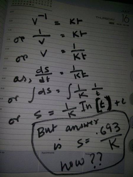

Could you find the distance?

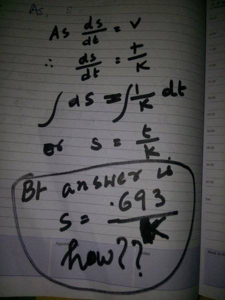

You would have to next integrate the velocity to get the distance.
Sorry I did mistake
romiomustdie said:
Sorry I did mistake
It should be as follows
Before you integrate the velocity to get the distance, you first need to get the equation for the velocity correct. So far it's not correct. See post #14.
Chet
Ya I had mistaken first bt how about the last upload
In that last upload, you starting equation is still incorrect. Did you upload the wrong file?

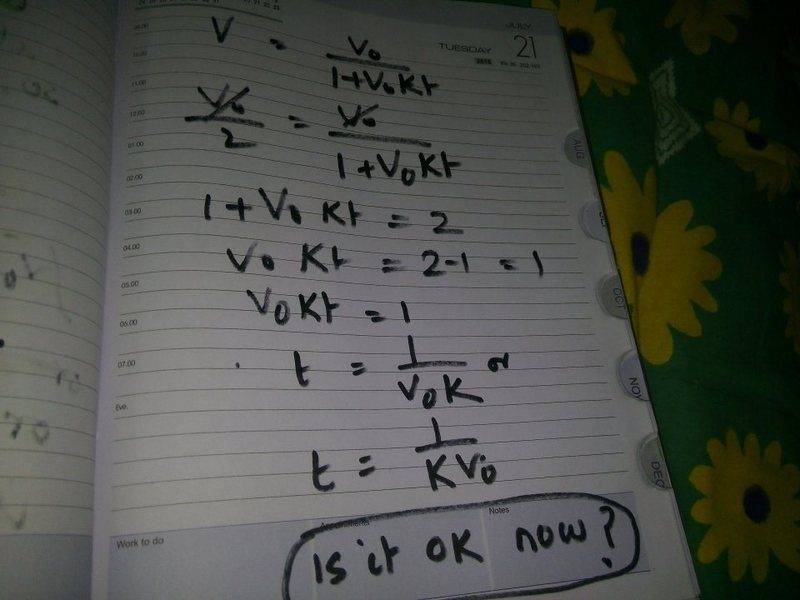

oh i got it u mean to say the derived equation for velocity is incorrect as i ignored constant of integration . but taking v=Vo , will not the constant of integration be equal to 0
or else how it should be ? please state
The problem statement says that the velocity is V0 at time t = 0. You need to make use of this fact in your equation for the velocity. I don't see any V0 in your equation for velocity.
Chet
romiomustdie said:
Sorry the image turned
I can't read it. The equation for the velocity is:$$V=\frac{V_0}{(1+V_0kt)}$$
