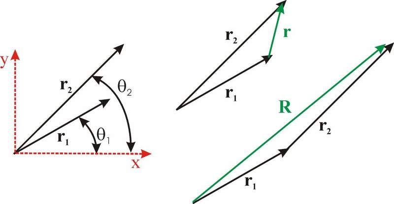

Consider the two vectors r1 and r2 shown in the diagram. The magnitudes of the two vectors are: r1=6.1 and r2=9.3. The vectors directions relative to the x-axis are defined by the angles: θ1=25 degrees and θ2=51 degrees
What is the magnitude of the vector R=r1+r2?
A = 15.0226
But how do I get that answer?
*Please refer to picture*
https://www.physicsforums.com/attachment.php?attachmentid=29294&d=1287716259
Resolve the vectors into x and y-components using the angles and trigonometry. Then add up the x-components of the individual vectors to get the x-component of the resultant. Same for the y-components. Once you have the x and y components of the resultant, you can use Pythagoras to get the total magnitude:
Rx = r1x + r2x
Ry = r1y + r2y
R2 = Rx2 + Ry2 (Pythagorean theorem)
OR instead of doing it using x and y-components, you could just determine the magnitude directly from the triangle in your diagram, and the cosine law.

Do you always use the cosine law?
I don't really know what you're asking. I mean, I just showed you a method of doing it that did not involve the cosine law (the first method). But, whenever the cosine law is applicable, then you can use it.
