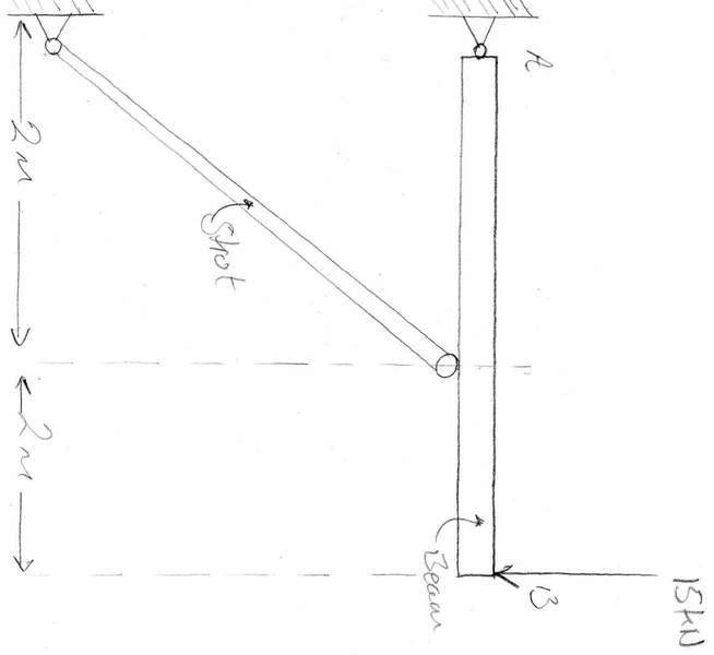

In the enclosed picture is a loaded beam and strut, what I need to do is determine the reactions at the supports. The problem is that I think the beam is indeterminable because there are more than three reactions?
I do no the three equations of statics but don't no how to apply them in this context
Could someone give me a hint in the right direction as to how to go about solving this problem?
Thanks in advance
James

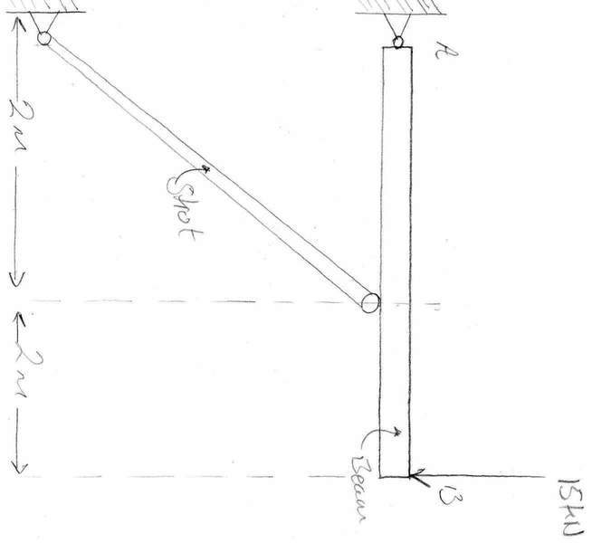

Another picture hopefully the right way round :-)
Sorry don't no why this is uploading the wrong way round. The reaction supports should be on the left side.
The hinge between A and the load gives you another moment equation which yields one more equation. So, take moments about this hinge, but just for the inclined member and its reaction components. In other words, the bending moment at the hinge is zero in the inclined member, but not in the vertical member.
