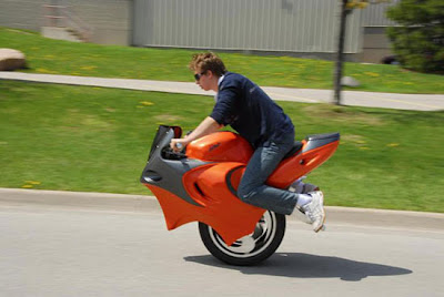

How does a unocycle / single wheel motorcycle work?
A unicycle or single wheel motorcycle operates by requiring the rider to balance through leaning, similar to balancing an inverted broom. To initiate movement, the rider must first lean in the opposite direction before accelerating forward. This balancing act is crucial as it opposes the driving moment that rotates the tire. Riding a motorized unicycle can be challenging and hazardous due to the lack of a second wheel for stability. The presence of a gyroscope aids in maintaining balance during operation.
It's similar to balancing a broom upside down. The rider would have to initiate a lean in the desired direction of acceleration by initially accelerating in the "wrong" direction first, then begin the actual acceleration. A motorized unicycle would be difficult and somewhat hazardous to ride. There are motorcyclists that can do wheelstands (balanced wheelie) indefinately, but they have the option of dropping the front tire back down if needed.
There is a gyroscope in it
