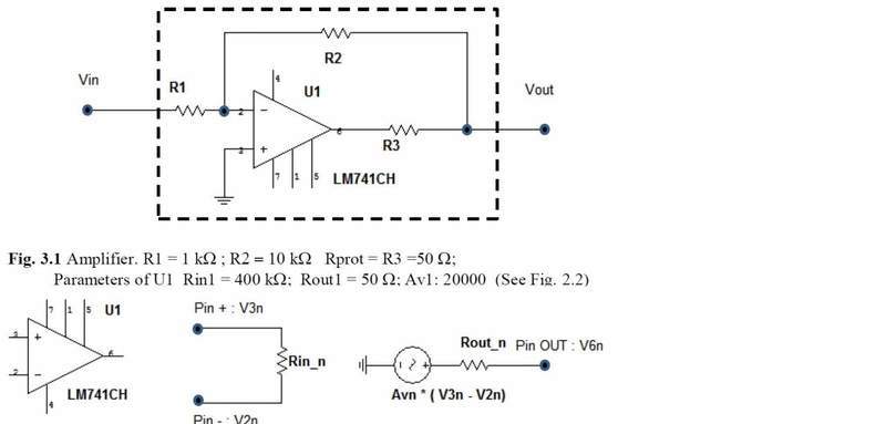

I have an un ideal OA aplifier(Amax=-9.975).
I have to evaluate its Rinput--> it has to be something like 10*10^10 Ω
I need to put a potenciometr after Vin and to "play" with it when I get half of Vout/vin.
when do I need to put it?
and what is my voltage equations? thanks.

Your text does not match your figure, as far as I can see.
What do you mean when you say "Rin has to be something like 10*10^10 Ω"? In the figure, Rin1 is given as 400 kΩ.
the resistance named Rin is 400K.
But: the input resistance of the circuit is not 400. that's what I have to find
So you'll redraw the circuit, this time replacing the triangle with a 400k resistor to ground at the input, and show a voltage source with a gain of 20000 and so on. Surround it with the external circuit resistances, then analyze that.
I don't know anything about putting a potentiometer somewhere and playing with it. Maybe that's something you do in the lab?
Given the actual gain of the circuit = 9.975 vs. the ideal op amp gain of 10.000 you can compute the open-loop gain of the amplifier.
You then compute the input current for a given inut voltage to get the circuit's input impedance.
You can then put a potentiometer in series with the 1K input resistor and determine the value needed to halve the output.
That is, if I understood what you are trying to say, which is dubious.
