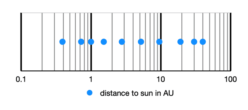

Below are the planets and dwarf planets plotted by distance from the sun.
Logarithmic number line from 0.1 to 100 labelled distance to sun in AU, with ten blue dots spaced between 0.4 and 40 AU.
Although the above plot might be useful, I don't understand how one would use a logarithmic ruler.
Data for above plot:
PlanetsAU
Mercury0.4
Venus0.7
Earth1.0
Mars1.5
Ceres2.8
Jupiter5.2
Saturn9.5
Uranus19
Neptune30
Pluto40

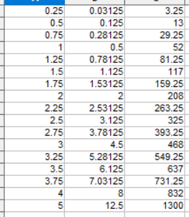

OK, turned out your spreadsheet idea saved the day.
Spreadsheet with three numeric columns: x values from 0.25 to 5, a second column of cubed values such as 0.03125 and 12.5, and a third column of values from 3.25 to 1300.
One day is 52.px.
That final column is total-pixels-from-zero.
