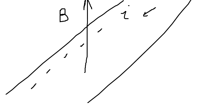

A current is flowing in a copper wire (electrons are flowing). The electrons will be deflected to the left wall of the wire due to Hall effect. They leave on the right wall of the wire a deficit of electrons, leaving them positively charged, so there’s a voltage difference between the left and right. An electric force will act on the electrons on the left.
  • Does the electric force 100% cancel the magnetic force qvB?
  • If ‘1’ is yes, how does the wire still feel a Laplace force/Ampere force iLB? If ‘1’ is no, does the wall of the wire give the electrons a normal/pulling force to balance them?
Is the wire allowed to accelerate under the magnetic force or is it mechanically restrained from accelerating?

Thanks. Would drawing a diagram be clearer?
I admit that drawing a figure would make the whole thing clearer but I am afraid I am not good on using drawing programs.
‘paint' in win10 will work

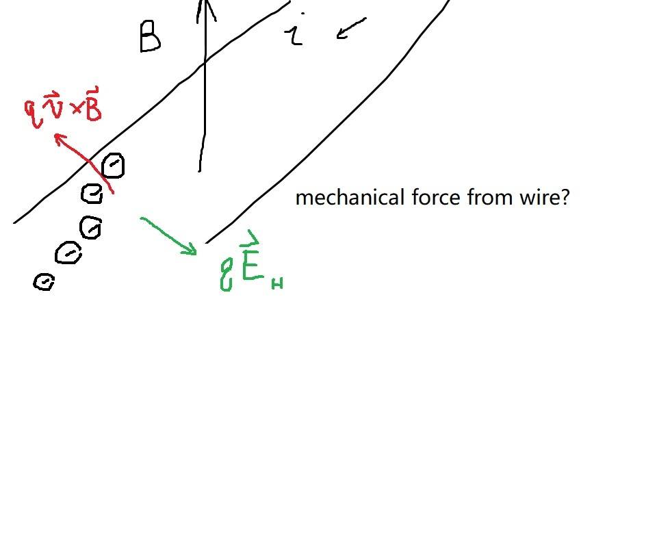

not yet, see the updated pic
vanhees71 said:
The figure is correct for a wire without an additional external magnetic field.
Then is there a mechanical force from the wire to help balance the charges?
feynman1 said:
no magnetic field, no hall effect
@vanhees71 do you imply there is a hall effect due to the magnetic field from the current of the wire itself and not from an external magnetic field?
I'm implying that there's an intrinsic Hall effect, i.e., the Lorentz force on the current elements due to the magnetic field of all the other current elements around and of course also a Hall effect due to an additional external magnetic field. It's all well explained by the Lorentz-force formula
$$\vec{f}=\vec{E} + \frac{1}{c} \vec{j} \times \vec{B},$$
for the force density. Here ##\vec{E}## and ##\vec{B}## are the total fields, particularly, ##\vec{B}=\vec{B}_{\text{self}} + \vec{B}_{\text{ext}}##.
