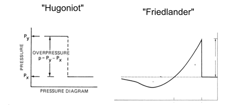

  • #126
I haven't fully digested this paper yet, but a scan of the figures and a text search fails to reveal any "negative overpressure" in their experiments.
I am not denying the existence of negative overpressure - the Beirut explosion and atomic blasts clearly indicate its presence.
I wonder if there is a missing controlling influence? Critical size of the blast, type of explosive, distance from blast centre, ...?

  • #141
Squizzie said:
If you are referring to individual molecules as particles, then my understanding is that, according to statistical mechanics, the molecules are individually moving in random directions at a mean speed of around Mach 1, and that the pressure in the blast wave is being transmitted by the molecules imparting momentum to their neighbours through their collisions over the distance of the few nanometers of their mean free path.
You are ignoring the rise in temperature of the air due to the shock front pressure rise. The speed of sound in hot air is greater than in ambient air. So the average speed of the molecules in the shock front is supersonic, >M1.
Indeed, all shock fronts that arise from an explosion are supersonic.
See: Kinney and Graham; Equation 4-34 .
  • #142
But isn't it the drop in temperature to below the dew point (and below ambient) in the negative phase that causes the condensation?
  • #143
That does not happen at, nor in, the shock front.
After the explosion, the outward momentum of the shock front, and the blast wave, have removed most of the combustion products and air from the site of the explosion. That volume is cooling and contracting to create the partial vacuum with condensation. The speed of the condensation wave front is slower than M1 because the front is hotter than the rear, which makes a ramp, not a step.
The blast wave will reverse at some point, flowing back in to fill the condensing gas and the partial vacuum that also causes. The wave that flows back in may again develop a step shock front, since it raises the pressure and temperature again at the site of the original explosion. That second wave is closer to ambient pressure and temperature, so the speed does not rise anywhere near the original explosive shock front.
Do not mix your viewpoints. You must decide to observe and discuss the shock front from a fixed position relative to the explosion, or travelling with the front itself, from the point of the greatest pressure step.
Do not mix your gas models. You must analyse the gas using statistical mechanics, or fluid mechanics.
Do not forget that a rise in pressure, causes a rise in temperature, which causes the speed of sound to increase, which steepens the pressure step of a shock front.

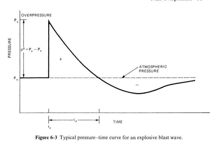

  • #144
Correct, and I am not suggesting that it does. Recall fig 6-32 from Kinney:
The negative phase ("-")is behind the positive phase (+) which commences at the instantaneous shock front at time ta.
