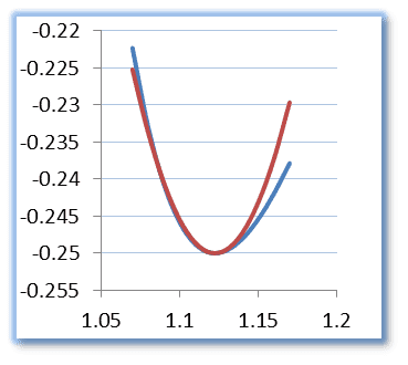

[edit] add plot of
$$U = {1\over x^{12}}-{1\over x^6}$$

I do the potential at ##r_{\text{min}}##
because it's fun :smile: with ##x_0 = \sqrt[6]2 ## $$ \begin{align*}
\left ( 1/x_0 \over 1+ x/x_0\right )^{12} - \left ( {1/x_0} \over 1+ x/x_0\right )^6 & = \\
{1\over 4}\left (1-12\;x/x_0 +144 \;(x/x_0)^2 ...\right ) -
{1\over 2}\left (1-6\, x/x_0 +36 \,(x/x_0)^2 ...\right ) & = \\
-{1\over 4} + 18 \,(x/x_0)^2 ... = -{1\over 4} + 9/ \sqrt[3]2 \;x^2 ... & \approx -{1\over 4} + 7.143\; x^2 ...
\end{align*}
$$ (my plot was a guess with ##9x^2##)
