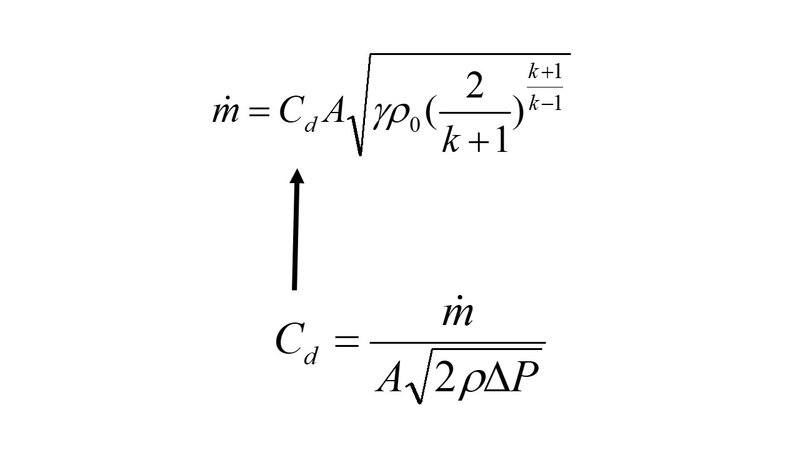

Okay, I got the equation on the web-page. I uploaded a file of what I found. I already have a few questions.
The [C][/d], if I insert the bottom expression into the general mass flow equation, it looks like the mass flow rate cancels out. That doesn't make sense to me. That's the arrow I put in the slide.
Also, the "k" in the (k+1)/(k-1) term, wiki didn't define what that is. What quantity does this represent?
My eventual goal is to find out how long it takes for the Mass of the gas to go to zero.
I will start with the easiest scenario, where everything (or as much as can be) is constant. Can I assume, just to begin easy, that the upstream pressure is constant, the temp of the gas is constant, the hole diameter would be large compared to thickness of the wall where the gas exits. I will have the specific heats constant.
What would be the simplest type of opening? The choices appear to be an "Orifice Plate", a "de Laval nozzle", and a "rocket engine nozzle".
For the delta-P, what would be the easiest pressure drop across the constriction for the simplest math? Can this term be constant, to start out with?
Can the density of the gas be constant, for the easiest case? Seems like it can't, since gas is leaving the hole. It also seems that the density of the gas should be a function of time, linked to the mass flow rate. Since density is mass per unit volume, can I simply convert density into the mass divide by the Volume, but leave the Volume constant since the Volume would be the unchanging Volume of the box? That would leave me with a diff equation with dm/dt on the left and "m" raised to the negative one-half via the coefficient [C][/d] on the right-hand side. Is this right? If not, how do I fix it?
I think I got everything in that equation. Let me know if I missed something.

Albertgauss said:
Also, does anyone know of any videos that show actual choked-gas flows in progress?
There wouldn't be anything to see. It's just a flowing fluid with no special characteristics other than the fact that it reaches sonic velocity at the location of smallest cross section.
Does anything visible happen at the hole (location of smallest cross section) when the gas reaches sonic velocity, or is that all invisible also? Just curious.
For most gases, it is invisible. You can view some compressible flow phenomena (such as shock and expansion waves) using techniques called schlieren or shadowgraphy. You can Google that and come up with all sorts of neat pictures. In the case in question here, nothing interesting would show up until after the flow leaves the hole, in which case there would be a series of expansion waves that might be visible with such techniques and a possible shock diamond structure downstream of that.
