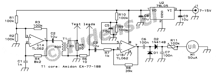

I have been looking at ESR meters for testing electrolytic capacitors.
Commercial ones are expensive, but this home-brew one seems interesting:
http://ludens.cl/Electron/esr/esr.html
The transformer may be a problem so I would reduce the frequency and try a small speaker transformer from a transistor radio.
It is possible to mock up a simple ESR meter if you have an audio generator and an oscilloscope.
You put a 1000 ohm and a 10 ohm resistor in series across the output of the audio generator set to 1000 Hz.
The 10 ohm resistor goes at the ground end.
Monitor the voltage across the 10 ohm resistor with the oscilloscope. Try to get a near full scale deflection.
Put the capacitor to be tested across the 10 ohm resistor.
If it is good, the trace on the oscilloscope should almost flat-line. If it is no good, the trace will hardly decrease in amplitude.
It can be used in-circuit if you used fairly thick wire as the test probes. Beware of capacitors that have a charge on them, even after the equipment has been turned off.
Excellent,,, Vk6, and it's analog ! ..
i love it.
Thanks for that Vk6kro. I just may have to make one of those.
