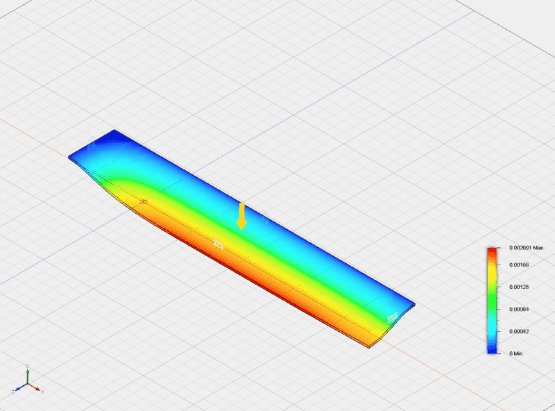

I have a plate of 600mmX92mmx2mm. All the four sides are fixed.How can I calculate the effective deflection at the center due to self weight considering the deflection in longitudinal and transverse direction?
Density of material 1170kg/m3
Modulus of elasticity 2.5GPa
Engineers quick solution - deflection will probably be very little .
Otherwise just search on ' deflection of a rectangular plate ' to find the standard analytic solution .
Come back if you have any problems .
That combination of material properties suggests that you are using some lightweight material such as plastic sheet .
If you are then be aware that your calculated value for deflection may not be very accurate . Order of magnitude will probably be ok but don't rely on the exact figure .

Thank you Nidium... Yea I am using some kind of POM. Just like a diffuser...If I calculate the deflection 2 dimensional then the longitudinal deflection comes around 10mm and in transverse direction its around .005mm. But in actual condition the sum effect of longitudinal and transverse deflection determines the scenario and I just wanted to know how to calculate the same. May be the order of magnitude will be enough.

ABS . Gravity load only .

Thats awesome!Thank you so much for the help. I believe the magnitude is in mm...
Yes mm . So deflection is very small .
Very easy to alter the model if you want to try another load case .
