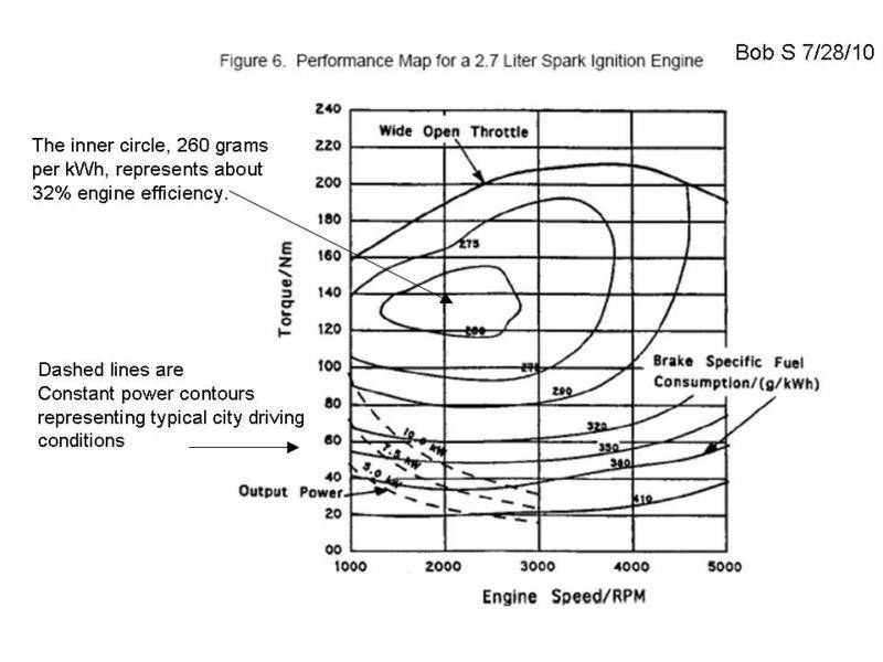

Hello,
I am trying to calculate how much fuel (petrol/diesel/LPG) it takes to accelerate a vehicle and well to cut a long story sort I seem to be getting my units mixed up also whether I should us small or big calories. Lastly is the incline and issue that I also need to consider and how do I apply it please?
So was wondering if someone could get me off in the right direction please?
Many thanks in advance
PS This is NOT a home work question!
For gasoline, oxidation of 1 gram releases about 44,000 Joules of heat. For 1 U.S. gallon, 120 million joules. But a conventional spark-ignited internal combustion engine, the conversion efficiency is typically ~20%.
The attached thumbnail of a brake specific fuel consumption (BSFC) plot shows the efficiency of a typical 2.7-L gasoline engine as a function of RPM and torque.
Bob S
If you are accelerating a vehicle up an incline, the resultant HP used is the change in potential energy plus the change in kinetic energy. Assuming you start from a standstill and zero reference position:
for the potential energy, W = mgh; for the KE energy, W = K= 1/2mv
and velocity (v) is at.
So you should expect to consume more fuel for greater height (steeper incline) and/or greater acceleration.
You'll also have to get an estimate of fuel consumption to produce a HP...that depends on the type of fuel, such as gas or diesel, type of engine, and a lot of other factors...but a reasonable average for modern diesel engines is that they produce 18 to 20 hp per gallon of fuel burned per hour.
