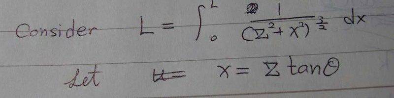

How to calculate this integral?
  • Thread starter Thread starter athrun200
    Integral
athrun200
275
Can I use this substitution?
Looks good, what does it come out to?

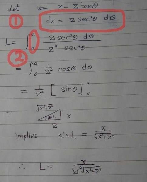

I am not sure for 2 things.
1. Since z is not a constant, does the derivative yield dz?
2. How can I write the range properly?
You're fixing a point z and calculating the electric field there, the limits are easy, you have L=\tan\theta and so the upper limit is \theta =\tan^{-1}L, the lower on is just 0.
hunt_mat said:
You're fixing a point z and calculating the electric field there, the limits are easy, you have L=\tan\theta and so the upper limit is \theta \tan^{-1}L, the lower on is just 0.
Thx!
For your limits of integration look at your triangle. (The angle you labeled L is actually θ.) If x = 0, then sin θ = 0 and if x = L, then sin θ = L/√(L2+z2) .
