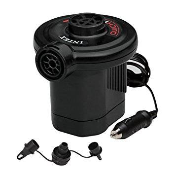

Let's say i have an air pump which produce plenty of air flow, but almost no pressure.
Is there a simple way to turn this high flow, low pressure into high pressure, low flow?
I'm thinking something akin to a gearbox turning fast spin, low torque of a motor into a high torque, slow spin output.
Or basically something like a lever - a simple mechanical concentration of force.
I tried putting a cone at the output, but it just reduces the amount of air going out without increasing the pressure.

You describe it as a "pump", which implies that it is a high pressure, low flow device, but then say it is generating high flow and almost no pressure. That doesn't make a lot of sense, but if the flow is higher than you need, you can probably just put a valve on the system to reduce the flow, which will increase the pressure.

It's a centrifugal "pump" like the image below, used to fill up air mattresses.
It produces a lot of air flow, but almost no pressure.
That is, it can quickly inflate a garbage bag, but won't force any air into a regular party balloon.
The latter is what i was thinking of using it for.

Sorry, but there isn't much that can be done to increase the pressure: it is purposely designed for low pressure so it doesn't pop air mattresses.
That is a centrifugal compressor if I'm not wrong. They CANNOT produce high pressure, especially with a gaseous medium.
Centrifugal compressors can produce high pressure, but this one isn't designed to. It's more of a blower/fan than a compressor (though the difference is largely colloquia).
Fans, blowers, pumps, compressors, whatever all have a characteristic performance curve whereby higher flow occurs at lower pressure and vice versa (shape is roughly like the upper right quarter of a circle). But there is a maximum pressure that they can achieve at zero flow. The performance curve for this one was purposely selected to provide a maximum pressure that won't pop an air mattress.

A lot of turboshaft and turboprop jet engines use centrifugal compressors, which will typically give a pressure ratio of something like 5:1 per stage (so a 2 stage centrifugal compressor can give ~25:1, though this depends on the specifics of each design). Wiki actually has a pretty good article on this: http://en.wikipedia.org/wiki/Centrifugal_compressorhttp://en.wikipedia.org/wiki/Centrifugal_compressor EDIT: actually, come to think of it, a high(ish) pressure centrifugal compressor you might be more familiar with also exists in many modern cars - specifically, a turbocharger. They all run centrifugal compressors as well.
