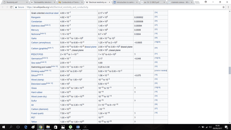

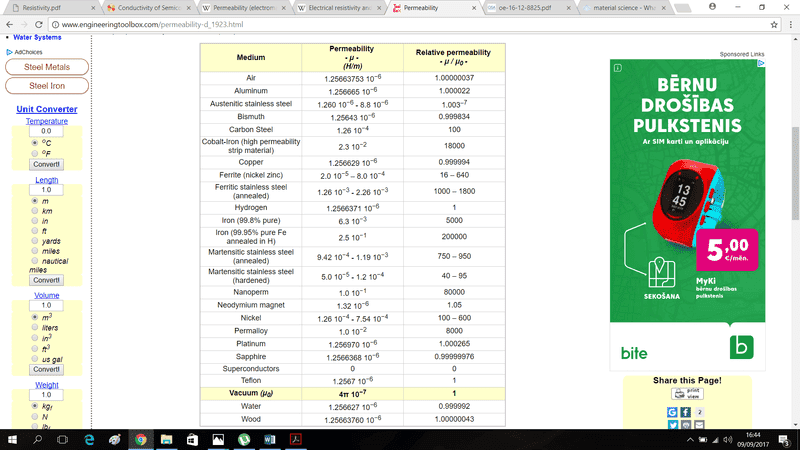

Hi,
could anyone tell me, if they have any ideas as to, what materials could be combined to produce a material with two characteristics- electrical conductivity of about 10 S/m and magnetic permeability of 7500.
Thanks in advance.

Good question, my bad there. A solid definitely, but that`s about it, when it comes to the state of the material.

  • A composite can be considered as a so-called effective medium with homogeneous material properties (e.g., effective conductivity and effective permeability). "Effective medium theories" allow to predict the effective properties as a function of the volume filling factors of the dispersed material particles. Maybe, it will be difficult to tailor two properties simultaneously.
  • On the other hand, it's possible that some ferrites have roughly these values for the electrical conductivity and magnetic permeability.
To reflect on composites (https://en.wikipedia.org/wiki/Composite_material) when one wants to produce materials with tailored physical characteristics is generally a good idea. Nevertheless, it can become - both scientifically and technologically - a challenging task to synthesize a material with specific properties by this means. That means, one needs to do more than looking for constituent materials which might – in combination - produce a material with characteristics different from the individual components. One has also to find a manufacturing process to finally “realize” such a combination.
Regarding generally a material with two characteristics- electrical conductivity of about 10 S/m and magnetic permeability of 7500: I suppose that MnZn ferrites (MnaZn(1-a)Fe2O4) might be suitable.
