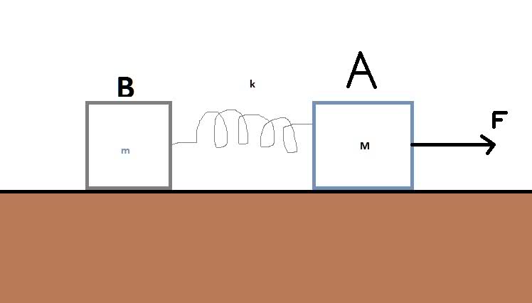

The situation is shown :-
All surfaces are frictionless. I am trying to find the max extension of the spring as the force is applied. Spring is massless.

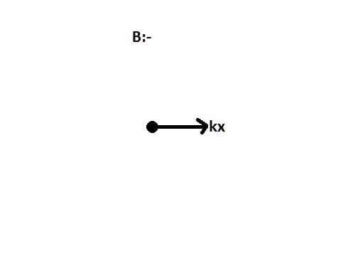

F=maI tried drawing FBDs for block A and B:-
F-kx=Ma(from fbd of A)
kx=ma(from fbd of B)
, we get
x=Fm/k(M+m)
Is this correct??
Also can anyone explain how to visualize when spring if stretched from both sides? How do you then apply Hooke's law?
