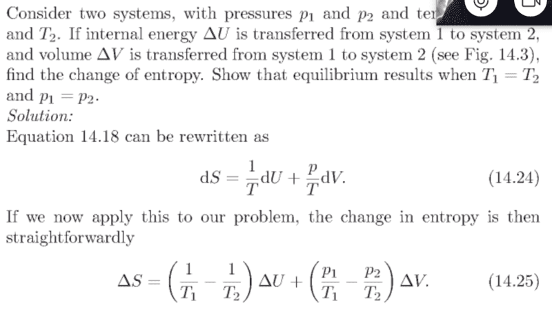

How to get from 14.24 to 14.25?
To me it looks like they got the signs wrong. ## \\ ## ## \Delta S_2=(\frac{1}{T_2}) \Delta U+ (\frac{p_2}{T_2}) \Delta V ##. ## \\ ## Meanwhile ## \Delta S_1=- [(\frac{1}{T_1})\Delta U+(\frac{p_1}{T_1}) \Delta V ] ##. ## \\ ## Then ## \Delta S _{system} =\Delta S_1+\Delta S_2 ## ## \\ ## @Chestermiller Did I get the sign wrong, or did the book get the sign wrong?

What I think you are saying, @Chestermiller is even if a quantity of heat ## \Delta Q ## goes from system 1 to system 2, there is no guarantee that it goes into the ## \Delta U ## term=it could also go into the ## p \Delta V ## term, so the problem really lacks definition. Did I understand your comments accurately?
I think what the question meant to analyze was a case where you have two systems in contact with one another having different temperatures and pressures, but with a constant total volume and a constant total internal energy. The combined system is insulated and rigid on the outside. The barrier between the chambers is released and allowed to move freely, and the system is then allowed to re-equilibrate. The idea is to determine the change in entropy from the initial to the final state, and to show that the only way entropy doesn't increase is that if the initial temperatures and the initial pressures match. For ideal gases, this problem can be analyzed without too much trouble. But I strongly disagree with using Eqn. 14-24 to analyze this because that equation applies only to closely neighboring equilibrium states of a system, and the equilibrium states would not be closely neighboring for each of the two chambers involved.
I don't understand why the equation only applies to closely neighboring equilibrium states, could you explain a bit more?

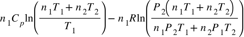

If my equation is correct, the total change in entropy for n1=n2=1 will be
mSAqh9G0fYeNZKDM7i5ZM6a6BkkvCBoKH51kAfJr9GWBpxx64Rvk255n54Huw7LaPLqqjFx_fTVJwilM7vIXHC6eE7Oc8Gxr.png
  • mSAqh9G0fYeNZKDM7i5ZM6a6BkkvCBoKH51kAfJr9GWBpxx64Rvk255n54Huw7LaPLqqjFx_fTVJwilM7vIXHC6eE7Oc8Gxr.png

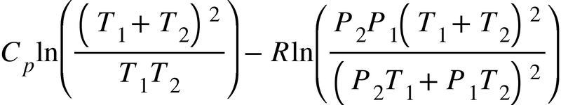

If I multiply and divide the expression in brackets of the 2nd term in your relationship by ##T_1T_2##, I obtain:
$$\Delta S=C_p\ln{\left(\frac{(T_1+T_2)^2}{T_1T_2}\right)}-R\ln{\left(\frac{(T_1+T_2)^2}{T_1T_2}\frac{\left(\frac{T_1}{P_1}\right)\left(\frac{T_2}{P_2}\right)}{\left(\frac{T_1}{P_1}+\frac{T_2}{P_2}\right)^2}\right)}$$This can be rewritten as:
$$\Delta S=C_v\ln{\left(\frac{(T_1+T_2)^2}{T_1T_2}\right)}+R\ln{\left(\frac{\left(\frac{T_1}{P_1}+\frac{T_2}{P_2}\right)^2}{\left(\frac{T_1}{P_1}\right)\left(\frac{T_2}{P_2}\right)}\right)}$$
OK so far? Note the similarity in mathematical form for the two logarithmic terms. I will continue after you indicate you are comfortable with these results.

OK. I am comfortable with the result
We are missing a factor of 4 in the denominator of each of the logarithmic terms. For example, for the first term, the final temperature is ##(T_1+T_2)/2##
I can write $$T_1T_2=\left(\frac{(T_1+T_2)}{2}\right)^2-\left(\frac{(T_1-T_2)}{2}\right)^2$$ so $$\frac{(T_1+T_2)^2}{4T_1T_2}=\frac{1}{\left[1-\frac{1}{4}\left(\frac{\Delta T}{\bar{T}}\right)^2\right]}$$ where ##\bar{T}=\frac{(T_1+T_2)}{2}##and ##\Delta T=(T_1-T_2)##. This expression is >1 for all values ##\Delta T\neq 0##, which means it always makes a positive contribution to the entropy change.
What does the same procedure tell you for the second term in the entropy change equation.
