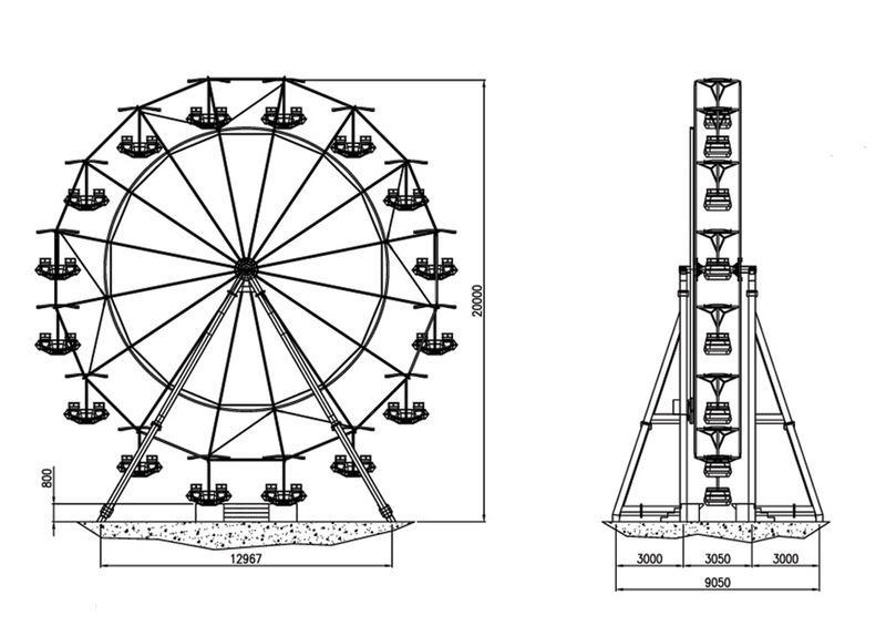

The geometry of the problem is not clearly stated. One can understand that the three wheels altogether cover 10.63 m distance, or each of them does.
a human cannonball in 1940 soared over three ferris wheels, each 18 meters high covering a horizontal distance of 10.63 meters. Assuming that the point of projection is 2.50 meters above the ground and that he landed safely on a net placed at the same level, find his initial velocity.
Looking at the picture of a Ferris Wheel, I am inclined to believe the second geometry is valid.
