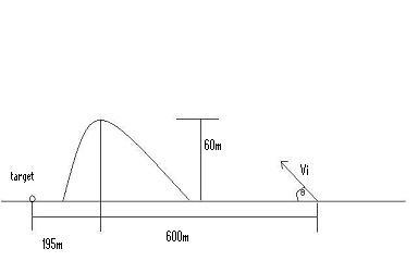

Problem : find a v_i and angle \theta that will be able to hit the target 795 m away and clear the 60 m hill 600 m away. I attached a picture of the problem.
I was trying to do this using the equation
y=y_0+(x-x_0)*tan(\theta)-\frac {1}{2}g (\frac {x-x_0}{v_0*cos(\theta)})^2
I used this by seperating the problem into two parts from the origin to x=600 m and y=60m (y_0 = x_0 = 0) and the second part from x= 795 m and y=0 m(y_0=60m , x_0=600m)
I know this is wrong, because I couldn't get an answer. I was wondering what the best way to approach this problem would be. Thanks in advance!

Try using your equation and finding the expressions for v_0 and \theta where (x,y) = (600,60) and (x,y) = (795,0)

In the last term, t (= x/vcos) should be squared:
60=600*tan(\theta) - \frac{1}{2}*g*\frac{600^2}{v_0^2cos^2(\theta)}
and
0=795*tan(\theta)-\frac{1}{2}*g*\frac{795^2}{(v_0^2cos^2(\theta))}
Substituting t=x/v_0cos(\theta) into the general equation of motion, you get the general solution to the quadratic for the range, R:
R = v_0^2sin^2\theta/2g
Then substitute that into the equation of motion to get:
y = xtan\theta - \frac{1}{4R}tan^2\theta where R = range (795)
By substituting x,y = 600,60 you have a quadratic equation in terms of tan(theta) only. You will have to check my algebra - I am not guaranteeing that I haven't missed something.

Someone asked my professor about this in class and he said we only need to use the equation y=y_0+(x-x_0)*tan(\theta)-\frac {1}{2}g (\frac {x-x_0}{v_0*cos(\theta)})^2 Once.
He said that we need to put v_0 in terms of \theta. and find a \theta that would give a minimum value of v_0.
v_0=sqareroot((\frac{.5*g*x^2}{x*tan(\theta)(cos^2(\theta))}))
using the (795,0) and x_0 = y_0 = 0
I was trying this but I don't recall how to find an angle that would give a minimum value. Can you offer any help regarding this ?
Thanks
Thanks for your help, I found the answer!
