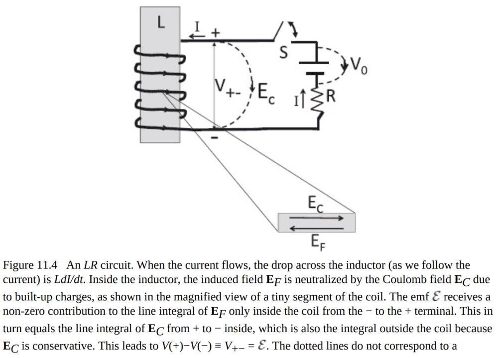

  • #61
rude man said:
Are you remembering that Em and Es point in opposite directions in the battery? Em is conservative, Es is not. What's the problem?
The problem is that these two statements are contradictory.
  • #62
etotheipi said:
which must be incorrect. In my frame of reference, I certainly wouldn't call ##\mathbf{v} \times \mathbf{B}##, or ##\frac{GMm}{qr^3}\hat{\mathbf{r}}##, or ##\frac{1}{q} \mathbf{f}_s## an electric field. Instead, an electric field ##\mathbf{E}## is the electric force (only!) per unit charge.
It appears you are generalising the term electric field to mean any force per unit charge, whilst this is surely a very unconventional (and probably incorrect) usage?
I am.
## F = q \bf v \times \bf B ## is equivalent to ##q \bf E ##.
Change you reference to the moving frame when ## \bf v = 0 ##. Then there is no lorentz foirce, just electric. If you have Resnick & Halliday intro physics text they do a nice job explaining this.
Also, relativity has shown that the Lorentz force is really an electric force. Feynman mentions this somewhere in his lecture notes. I don't pretend to understand it but there it is.
But even then, this still wouldn't explain why you think ##\mathbf{f}_s## is not conservative.
As I said several times, if Em were conservative the E field circulation would be zero, and it's not, it's the emf.

  • #63
They're not, and please explain why you think they are.

  • #66
If some vector field ##X## is conservative then so is ##-X##

  • #70
rude man said:
So did Feynman.
Could you produce a reference for this?
There is an electromagnetic field ##(\mathbf{E}, \mathbf{B})##. In an inertial frame of reference, as @vanhees71 said, it has 3 magnetic and 3 electric components, and the Lorentz force is ##\mathbf{F} = q\mathbf{E} + q\mathbf{v} \times \mathbf{B}##. In my inertial reference frame of choice, these two terms ##q\mathbf{E}## and ##q\mathbf{v} \times \mathbf{B}## are not the same, since clearly one is an electric force and one is a magnetic force.
In different inertial frames of reference in relative motion, the measured fields are different in both frames. However in each I can quite clearly distinguish between a magnetic field and an electric field in my frame.
rude man said:
It is not. Never was, never will be. And I certainly didn't say so.
I maintain that ##\mathbf{f}_s## is conservative between the terminals, because I can write it as the derivative of a scalar field. Though I have said this about 6 times, so I have the feeling saying it once more won't change your mind.
  • #71
rude man said:
If ##-X## is just ##X## with polarity reversed, sure. But not if they have different sources.
We say a vector field [itex]\vec V[/itex] [in ordinary Euclidean space] is conservative
when [itex]\vec V[/itex] satisfies [itex]\vec 0=\vec \nabla \times \vec V[/itex] (everywhere).
Observe that when "[itex]\vec X[/itex] is conservative", then
"[itex]c\vec X[/itex] is conservative", for any constant [itex]c[/itex],
since [itex]\vec \nabla \times (c\vec X) = c\left( \vec \nabla \times \vec X \right) =\vec 0[/itex].
Thus, "[itex]c\vec X[/itex] is conservative".
In particular, "[itex]-\vec X[/itex] is conservative"
To claim that [itex]\vec X[/itex] is conservative but [itex]-\vec X[/itex] is not conservative",
suggests that you are misusing the definition of a vector field being "conservative".

I haven't studied this discussion in detail, but I think I see one area that I may lend some insight: The field ## E_m ## is something that is non zero only inside the battery. The field ## E_s =-E_m ## for an open circuit battery, but only inside the battery. Outside the battery ## E_s ## is clearly different from the ## E_m=0 ##, so that ## E_s ## being irrotational does not imply ## E_m ## is irrotational, (which it isn't).
  • #87
and a follow-on: Upon a little study of the inductor, I don't know that you would want or need to apply Helmholtz's theorem to the ## E_{induced} ##. It is clearly not irrotational, but I don't know that it necessarily has ## \nabla \cdot E_{induced}=0 ##. The ##E_m ## of a battery can be treated mathematically as being similar to the ## E_m=E_{induced} ## in an inductor. I do see some merit to @rude man 's approach.
  • #88
Charles Link said:
and a follow-on: Upon a little study of the inductor, I don't know that you would want or need to apply Helmholtz's theorem to the ## E_{induced} ##. It is clearly not irrotational, but I don't know that it necessarily has ## \nabla \cdot E_{induced}=0 ##. The ##E_m ## of a battery can be treated mathematically as being similar to the ## E_m ## in an inductor. I do see some merit to @rude man 's approach.
I think surely the easiest way to treat the lumped inductor is to calculate the voltage via ##V = -\int_a^b \mathbf{E} \cdot d\mathbf{l}## along a path outside the component, and ##\mathcal{E} = \oint \mathbf{E} \cdot d\mathbf{l}## around the closed curve through the inductor and around the outside of the component. And since ##\mathbf{E} = \mathbf{0}## inside the conductor, you get out ##V = -\mathcal{E}##. It's also important to note that ##\nabla \times \mathbf{E} \neq \mathbf{0}## inside the inductor even though ##\mathbf{E} = \mathbf{0}## inside the wire and this is why you can no longer constrain ##\oint_C \mathbf{E} \cdot d\mathbf{l} = 0##.
With that out the way, I'm not entirely sure how one would go about the decomposition you were referring to inside the wire of an inductor; however you decompose ##\mathbf{E} = \mathbf{E}_1 + \mathbf{E}_2 = \mathbf{0} \implies \mathbf{E}_1 = -\mathbf{E}_2## inside the inductor wire; if ##\mathbf{E}_1## is conservative then so is ##\mathbf{E}_2##, and vice versa. And also inside the inductor wire you have ##\nabla \times \mathbf{E} = -\partial_t \mathbf{B} \neq \mathbf{0}##. So I don't know how this decomposition can make sense. Perhaps someone else can comment?
The battery is different, since there you have two equal and opposite conservative fields ##\mathbf{E} = -\frac{1}{q} \mathbf{f}_{chem}## and no time varying magnetic fields which might cause rotational induced electric fields. But for the inductor, I'm not sure if it makes sense at all to perform any decomposition into two parts.
  • #89
@etotheipi For the case of the inductor, we previously treated it in detail in a couple of threads on this forum, and we were very satisfied with the conclusions that included such a decomposition. See https://www.physicsforums.com/threa...asure-a-voltage-across-inductor.880100/page-5 This one really covered it all, including Professor Lewin and the KVL problem. ## \\ ## Just to summarize for the inductor, inside there is an ## E_{induced} ##. We have ## \int E_{induced} \cdot dl=\mathcal{E} ##. In order to get a finite current in the inductor, we must have an ## E_s=-E_{induced} ## in the inductor. Because for the whole loop ## \oint E_s \cdot dl=0 ##, outside the inductor we have ## \int E_s\cdot dl=\mathcal{E} ## to match the ## \int E_s \cdot dl=-\mathcal{E} ## inside the inductor. It really is very straightforward.
  • #90
Hi Charles,
OK except I just finished reminding @Dale that ## \nabla \cdot \bf E=0 ##.always holds for any electric field ## \bf E## unless charge is present at that point, whch of course it isn't. It's one of Maxwell's four equations.
