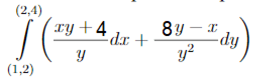

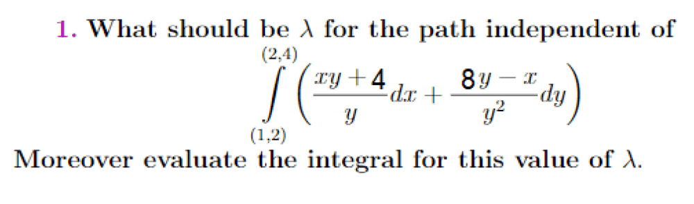

I have a question like this;
I selected lambda as 4 (I actually don't know what it must be) and try to make clear to myself like
these limits (1,2) and (2,4) is x and y locations I think :)
If I find an answer for part one of the integral following, I would apply this on another:
My solution was :
I wonder whether it is correct. If it is not, how must I imagine?
Note: If there is someone who has an idea about original question, please leave a comment. I appreciate it :)

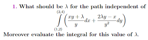

You must select lambda so as the integral is path-independent, that is the integrand is exact differential .

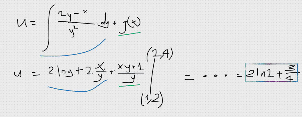

I chose second one and found the answer like this. Idk whether it is incorrect. So I'll try for the first one for the same logic, I'll see if it will get the same answer.
Edit: from first one, because of there is no natural logarithmic situation, we can't get ln2 or something
What about this? it's just another ostentatious way I think.
Note it's not about my question, just an example.
I do not understand what you did.You can get u(x,y) by integrating the second partial derivative with respect to y. Then determine the function g(x) by taking the partial derivative of u(x,y) with respect to x and make it identical to x+1/y.
I did what you said at #9. Can you check out that for me?
Your answer is not correct as you can verify that for your ##\phi##, ##\phi_x = P,~\phi_y = Q## fails. The problem is you have an extra ##\frac x y## in your answer. You really need to read the link I mentioned in post #7. In particular the last example.

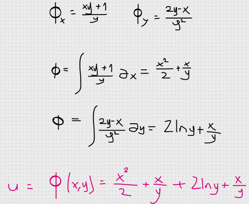

requied said:
I found the potential function u like this:
I don't know why but it seems correct to me.
No, it is wrong. You just took the sum of the two integrals. Why?
When integrating, you have to include a constant. In this case, the integral with respect x has a "constant" that does depend on y. When integrating with respect y, the constant depends on x.
The two ##\Phi(x,y) ## functions must be identical:
x^2/2+x/y+f(y)=2ln(y)+x/y+g(x)
What should be f(x) and g(y) so as the last equation is true?
