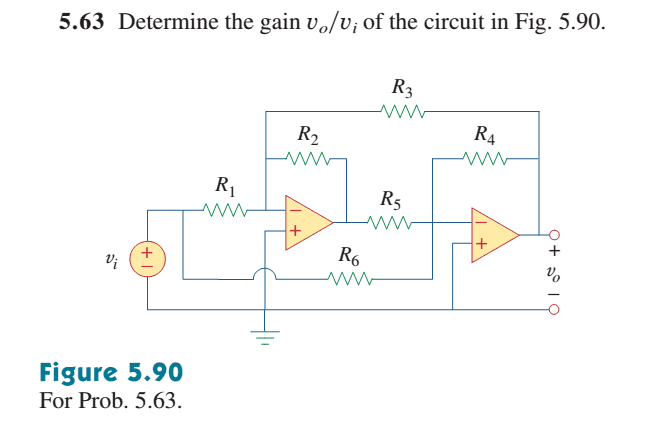

This is not directly a homework question, as I found the answer. The question did not specify that compartmentalization be used, but it was in the section of Cascaded Op Amps, and the general idea of the section is to compartmentalize such complex looking circuits into cascaded stages of inverting, non-inverting, summing, or difference op amps.
I took the long way round and got the answer using Kirchoff's Laws and systems of equations.
However, can this circuit be compartmentalized into op amp stages, and if so, how? What are the stages?
Circuit schematic with two op amps: input source vi feeds R1 into the inverting input of the first op amp, with R2 in feedback from output to the non-inverting input and R3 across the output; R5 and R6 connect to a second op amp with R4 feedback to output vo.
imgur link: http://i.imgur.com/kYrp99R.png
it's a cascading 2 stage inverting op-amp arrangement with addition feedback provided by R3 and R6D
Averagesupernova said:
Need some more details here. There are no resistor values.
There's not meant to be. The only assumption is that none of them are zero or infinite.
Right, how do I handle that feedback? Can I wire it up outside the inverting op amp stage, or is it crossing into the stages? Because R3 seems to alter the internal feedback of the inverting op amps, and R3 is wired up to in between the voltage source and the first inverting op amp, doesn't this cause a problem for compartmentalization?

Does this work for you? It treats each stage separately.
1) Label the output of the first stage as "Vx"
2) Vo= -(R4/R5)*Vx -(R4/R6)*Vi
3) Vx= -(R2/R1)*Vi -(R2/R3)*Vo
Then substitute Eq.2 into Eq.1
p.s. note that R3 supplies positive feedback
Based on the diagram you posted I would assume the answer to the question is a specific voltage gain. In the case of all resistors being the same I would think the gain would be zero.
No :), I found the answer, and it matched the answer given in the back of the textbook, and that answer was an algebraic expression in terms of the resistances.
You can think of the output of an op amp as a dependent voltage source.
With that being said the two stage are isolated.
You can see that the second op amp is in an inverting/summing configuration (the two source being summed are the output of the first op amp and vi).
The first op amp is in an inverting configuration with addition feedback coming from the output of the second op amps (through R3).
you can solve this by writing two KCLs, one at the negative nodes of the op amps. You cannot completely isolate the two signals. Because of the feedback, they are dependent in some way.
note. R6 is not a feedback resistor. It will not effect the gain of the first op amp, due to the fact that it is tied to an ideal voltage source.

Right, so one does need to apply KCL equations, you can't just box the two up and use the standard formulas for the two different op amp types.
Great explanation, thanks! :)
so what is R6 doing ? ...it's function in this circuit ?Dave
its a feed forward path for vi to the second op amp. In a non ideal circuit (vi having output impedance, wire inductance/resistance, etc) r6 would have some effect on the gain of the first op amp. Any feedback signal is mitigated by the ideal source.

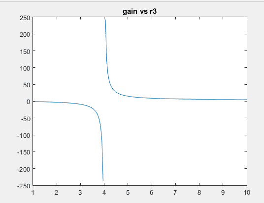

well the gain of the circuit is
vo/vi= (G2G6 - G1G5) / (G3G5-G2G4)
Gx=1/Rx fyi
so you can size the resistors such that the circuit will have either an inverting gain, or non-inverting gain, as well as attenuate or amplify. This is actually a really cool circuit!
I plugged some numbers into your equation and came up with a gain of -3 when using 1 for R1 and R5 and using 2 for R2, R4, R3 and R6. Then using KCL I came up with a gain of 3 ignoring R3. So you are telling me that inserting positive feedback by inserting R3 will cause the output to swing 180 degrees? KCL has never failed me yet. Am I doing something wrong?
no i don't think you're doing something wrong, I get the same results. Like I said this is an interesting circuit.
It seems with the values you chose, and varying R3 something interesting happens.
as R3 increases from 0 to 4 the gain goes from 0 to - inf.
then R3 from 4 - inf the gain moves from inf to three.
weird
i'm sure you can use this circuit layout in combination with a pot to capture a range of transfer functions.
you would have to choose your resistor values carefully, but it could be done.
  • Plot titled "gain vs r3" of gain against r3 from 1 to 10, with a curve that dips below zero near 1, plunges to negative values and rises to positive values in a vertical asymptote near r3 = 4, then decays toward zero.
I will not claim to know how you came with your equation but I cannot see how R3 being zero ohms can cause the gain to be zero when the other resistor values are as I set them. You do agree that R3 in any resistance value causes nothing except positive feedback correct? I can see that considering everything ideal with absolutely zero offset error and no thermal noise that with no input voltage the output will be zero even with R3 being zero. But then assuming a 1 volt input the current will ALL get shunted away from the inverting input of the first stage by R3. It would end there except R6 is providing a signal to the second stage and once the second stage has any voltage on its output it will hit the rail since there is a lot of positive feedback with R3 being so low. This is interesting. Hoped this would not come to a p!ssing match. I will admit I was very sleepy when making my last post in this thread. I still say it seriously resembles a Schmitt trigger.
the math doesn't lie. it doesn't change simply because you don't believe it. there might be feedback in r6 BUT there is also negative feedback in R2. Thats why this circuit is so interesting.
if you don't believe me solve the circuit with R6 in the circuit (I'm not sure why you took it out at all).
if you analyze the circuit with variables instead of numbers you'll be able to evaluate the transfer function easier and better.
I am not sure we are arguing the same point. I removed R6 for simplification in post #15. After that it has never been removed. I have never said there is feedback of any kind in R6. The fact that you have R3 feeding from the output to the input of 2 inverting op amps chained together guarantees positive feedback. Nothing you can do with R6 will change that.

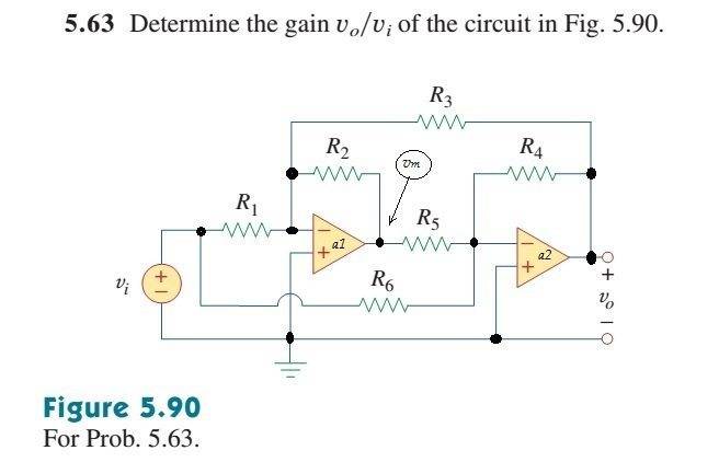

I like Tom G 's idea
Adding dots at the nodes shows there's only 3 of them with nonzero voltage
so i labeled the middle one vm
and labeled the amplifiers a1 and a2
Circuit schematic labeled Figure 5.90 with input source vi, resistors R1 through R6, two op-amps a1 and a2, node voltage vm, and output vo.
at a1's summing junction
vm/R2 + vi/R1 + vo/R3 = 0
at a2's summing junction
vm/R5 + vi/R6 +vo/R4 = 0
normalizing vm in both gives two equations
(1) vm + viR2/R1 +voR2/R3 = 0
and
(2) vm + viR5/R6 + voR5/R4 = 0
subtract (1) from (2)
vi X (R5/R6 - R2/R1) + vo X (R5/R4 - R2/R3) = 0
will try to align numerator and denominator in next lines,
...(R5/R6 - R2/R1)
vo/vi = ------------------------ ( latex won't do it, had to use periods to align them)
...(R5/R4 - R2/R3)
so this circuit has the interesting properties that
if all resistors are equal gain is indeterminate , zero / zero
if R5/R6 = R2/R1 gain is zero
R5/R4 = R2/R3 makes gain approach infinite
if my algebra is okay ( I'm prone to algebra mistakes)
