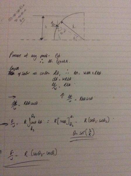

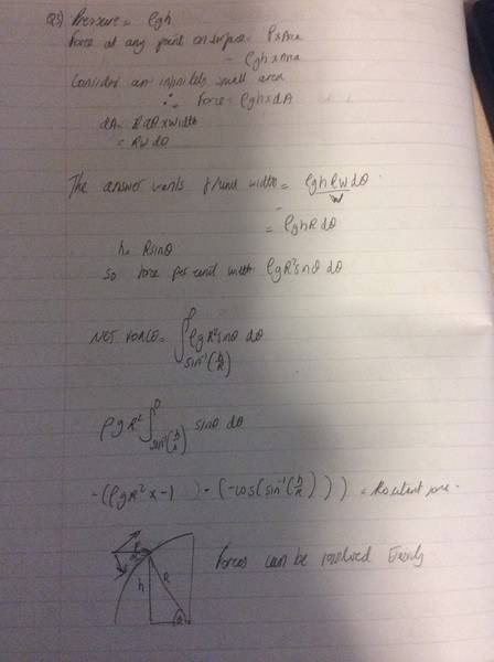

Can someone please help..There's no answers and I think my answer is very wrong, as you can see I have pretty much no idea what I'm doing.
Thanks
Edit:
Where it says net force I meant to say net force per unit width.
Edit2: My integration is wrong, it should read Density*gravitational constant*R^2(-1+cos(sin^-1(h/R)))

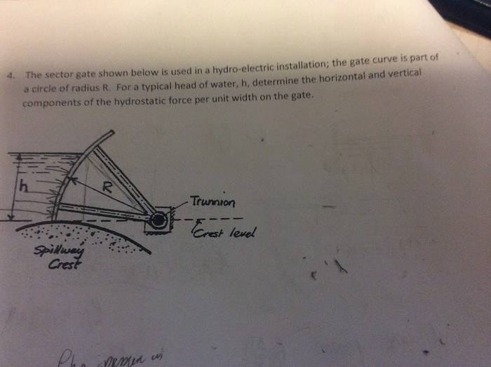

The pressure at a given depth is isotropic, meaning that it acts equally in all directions (i.e., perpendicular to any surface of arbitrary orientation). You correctly determined the force per unit width between Θ and Θ+dΘ as ##\rho g z Rd\theta##, where z is the local depth. This pressure force is acting perpendicular to the surface of the gate at depth z. So, you need to resolve this local force into components in the horizontal and vertical directions. You then integrate the horizontal and vertical components over the wetted surface of the gate.

Thank you for replying, I appreciate it a lot. Does this solution look better to you? (the first F/width is in the x direction and the one after in the y direction).
Hi Tom,
This solution really isn't correct. But I think I can help you to arrive at the correct solution by asking you a sequence of leading questions.
At a given angle Θ, what is the depth of the location on the gate below the surface (in terms of R, h, and Θ)?

Thanks for sticking with this, I thought h was the local depth (variable?), maybe I misunderstood the diagram. If we call h is a constant (representing the distance between the crest level and the surface of the water) then the local depth would just be [tex]z = h - Rsin \Theta[/tex]
So the force per unit width acting perpendicular to the gate at [itex]d \Theta[/itex] would be [itex]\rho gzRd \Theta = \rho gR(h-R \sin \Theta) d \Theta[/itex] is that correct? If so, should I resolve that into it's horizontal and vertical components and then integrate from there?
Tom! You're the man! Excellent!
The answer to your question is yes.
Chet
