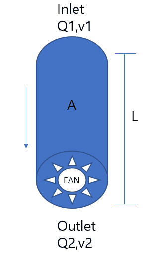

Hauzen
Hello
I need your help studying hydrodynamics.
I have a question about the volume of air.
Assuming incompressibility, non-viscosity, there is a coefficient of tube friction, and it moves in laminar flow...
The Oulet stage Fan is installed, so air moves from top to bottom. The cross-sectional area is A.
At this time, is inlet V1 and Oulet V2 the same or different?
If it's different, can it be expressed in a formula?
If the flow is non viscous, friction with pipe wall is zero. I don’t believe you can have “laminar flow” without viscosity. The shear stress at the wall is what forces the velocity gradient. Basically, One can’t keep their cake and eat it too.
But in general for “incompressible flow” and no reservoir for mass to accumulate what goes in must come out.
Hence: $$Q=A_iV_i = A_oV_o$$
However, gases like “air” are compressible and viscous, and can only be modeled as “incompressible, non-viscous” under certain conditions ( within some boundaries ).
Perhaps you meant fluid dynamics, which is a subdiscipline of fluid mechanics.
Hydrodynamics is the study of liquids in motion.
Aerodynamics is the study of air and other gases in motion.

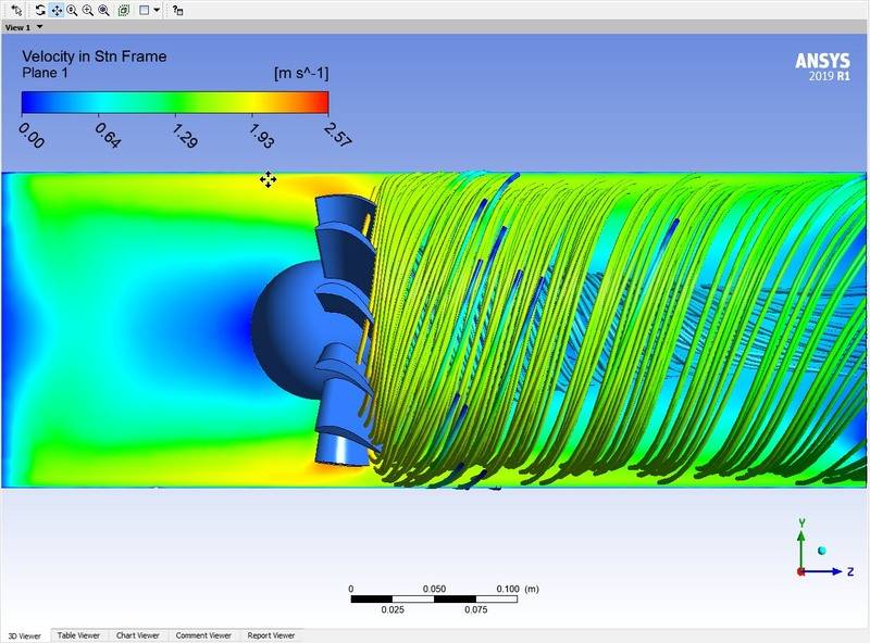

Fluid mass in = Fluid mass out
Volume is a matter of density and flow distribution at each small cross-area of a cross-section.
Axial fans can make a mess of cross-sectional velocity profiles.
If the In-volume is compressed or expanded within the duct or tube, Out-volume is different to the former; but still mass in=mass out.
Thank you so much for the CFD interpretation
I understood that very well.

Hauzen said:
I understand m1=m2, but is it a part that can be proved by the Q1>Q2 hydrodynamic formula?
You are welcome.
What Q1 and Q2 stand for?
Is it simply velocity times cross-sectional area, as shown in post #2 above?

Lnewqban said:
You are welcome.
I'm sorry for the late response because it's Korean time.
Yes, that’s right.
Assuming that it is a pipe that descends vertically, and that the lower fan rotates to draw air from top to bottom (at low speed, close to incompressibility), I would like to prove how the inlet airflow Q1 and the outlet airflow Q2 differ.
In fact, I would like to prove that the air volume (Q1) of Inlet and the air volume (Q2) of Outlet are different in the duct designed as shown above.
Is it a part that can be logically proved by Bernoulli's formula or other theory?
I'd like to prove it with a formula.
"close to incompressibility" implies ##Q_1## and ##Q_2## do not differ in any substantial way. It seems like an inconsistent question is being asked.
The OP wrongly assumed that there was no viscosity. That contradicted the OP assumption of there being "tube friction".
There's something that's hard for me to understand.
Assuming an incompressible fluid is flowing, friction would reduce the static pressure. Is there a moment when the length of the pipe is infinite and the static pressure becomes zero? I wonder if the dynamic pressure would decrease at that time.
The dynamic pressure is the equal at both ends of the pipe.
Imagine you have a horizontal pipe of length ##x##. Applying the "Energy Equation" ( a formulation of the First Law of Thermodynamics under certain simplifying assumptions )
$$ \frac{P_1}{\rho g } + z_1 + \frac{V_1^2}{2g} = \frac{P_x}{\rho g } + z_x + \frac{V_x^2}{2g} + \sum_{1 \to x } h_{loss} $$
Simplify. No change in elevation inlet to outlet ##z_1 = z_x##, hence:
$$ \frac{P_1}{\rho g } + \cancel{z_1} + \frac{V_1^2}{2g} = \frac{P_x}{\rho g } + \cancel{z_x} + \frac{V_x^2}{2g} + \sum_{1 \to x } h_{loss} $$
$$ \frac{P_1}{\rho g } + \frac{V_1^2}{2g} = \frac{P_x}{\rho g } + \frac{V_x^2}{2g} + \sum_{1 \to x } h_{loss} $$
Next assumption: Incompressible flow ( uniformly distributed velocity across inlet/outlet for simplicity ):
$$\dot m_1 = \dot m_2$$
$$ \cancel{\rho} A_1 V_1 =\cancel{\rho} A_x V_x $$
With ##A_1 = A_x##, ##V_1 = V_x ##, hence:
$$ \frac{P_1}{\rho g } + \cancel{\frac{V_1^2}{2g}} = \frac{P_x}{\rho g } + \cancel{\frac{V_x^2}{2g}} + \sum_{1 \to x } h_{loss} $$
i.e. Dynamic pressure at 1 is equal to dynamic pressure at ##x##.
Caneling terms, we are left with(re-arranging):
$$ \frac{P_1- P_x}{\rho g } = \overbrace{\sum_{1 \to x } h_{loss}}^{\text{Heat}>0} $$
So if ##P_x## is 0 gage (atmosphere), we simply have that at the end of the pipe ( position ##x##) all the static pressure at ##P_1## is converted to heat.

Wow! thank very much!!!
Thank you for your detailed explanation.
I understood it perfectly when I expressed it in a formula like this.

Hauzen said:
... I would like to prove how the inlet airflow Q1 and the outlet airflow Q2 differ.
That will be very difficult to prove, because Q1 and Q2 are equal.
