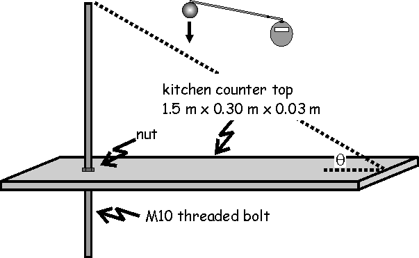

So more ideas for your project.
The stopwatch is operated by a lever at the starting position.
The idea behind the threaded bolt is to adjust the angle to obtain the correct time.
What problems dou you have with calculating the angle of the incline?

I like the bolt idea, my little brother had mentioned something like that to me. I believe that he is going to help me in the actual construction of the ramp, along with my other group members.
Where did you find that image, or did you draw it up?
I drew it with CorelDraw.
If you operate the stopwatch via some interaction with the ball just check that it does not deliver a substancial force to the ball. Although I think that the rules of the design did not specify that the ball should start out of rest!
You should also check that the surface that the ramp is resting on is level. Maybe by pouring some warm water with a bit of detergent on it. If this will get you into trouble you should maybe put some plastic on it first.
Show us your acceleration calculation thus far so that we can help you. The best appoach is to use the calculated angle just as an initial setting. It is best to then set final adjustment via a calibration curve.

Here are my calculations so far. I am sorry if they seem messy, they are handwritten. [ yes, I know that I have unit problems and sig. fig. problems.. sorry]

In your calculation for the acceleration of the ball down the ramp your end velocity is a sort of average velocity since the ball are accelerating down the ramp. The initial velocity is assumed to be zero, but then in your calculation you've got
v_i = \frac{?}{.9s}
Another way of calculating the acceleration of the ball down the ramp is via the known distance that the ball will travel and the given time. Also assume that the ball will start out of rest.
Are you contemplating in using a ping-pong ball? The mass is awfully small. So I assume that the ball is hollow. The formula I gave you is for a solid, not hollow ball. So you need to consider another type of ball. I feel that the chances of you current ball slipping is great. Rather go for a hard rubber type ball - a super ball with more mass.
Please write with a very soft pencil, maybe 2B. It is difficult to see your work as it is.

As I say. Please bear with me I am a Physicist. Let's try and get things right.
Rather do the acceleration calculation as follows. We assume that the given information is correct for the 1 meter distance, that is that the conditions must be such that the ball need to cover the distance in 1.8 s. The acceleration can then be calculated with
s = 0.5at^2
The assumtion that the ball need to cover 0.5 meter in half the time is a bit cock-eyed. Some one's physics is a bit off, unless I misunderstand the problem. So calculate the acceleration with the info for the 1 meter distance and then recalculate the time for the half meter distance since it seems that you are going to measure the time over half a meter.
The acceleration should come out a bit different from your 0.7 m/s^2.
Your mass is definitely wrong for a four centimeter super ball. I would estimate that it should be in the order of 100 - 200 grams.
