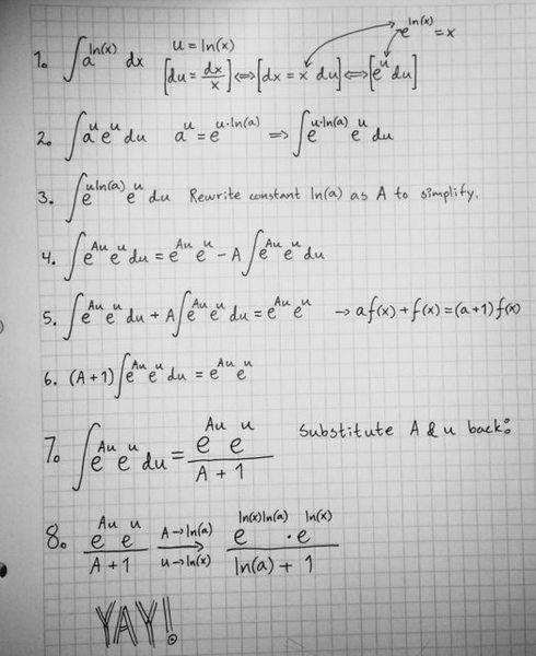

I'd like some feedback on my approach to solving this integral
tomvidm
1. I gave myself the task of solving the indefinite integral of an exponential function whose base is any real valued constant and whose power is a logarithm of the variable I am integrating over. Now my question is not how to solve it, but rather, whether or not my approach was efficient. I've just started practicing doing the u-substitutions, so my approach was centered around that, but it also involved integration by parts. Below is an image of my paper containing all the information I think is needed.
Handwritten derivation on grid paper numbered 1 to 8: integral of a^ln(x) dx, substitution u = ln(x) with du = dx/x, then integration by parts and rewriting a^u as e^(u ln(a)), ending with the result e^(ln(x)ln(a)) times e^ln(x) over ln(a) + 1.
Was my choice of technique good or could I have solved this integral in some other manner?
(Also, I removed the points 2) and 3) which comes with every thread here. I think the image speaks for itself.)
There is a faster way. Note that [itex]a^{lnx}=(e^{lna})^{lnx}=(e^{lnx})^{lna}=x^{lna}[/itex], which is very easy to integrate. Your answer can be simplified by noting that [itex]e^{lnx}=x[/itex] as long as x>0, and the two answers will be identical.
Edit: This is a minor point, but never forget your constant of integration!
