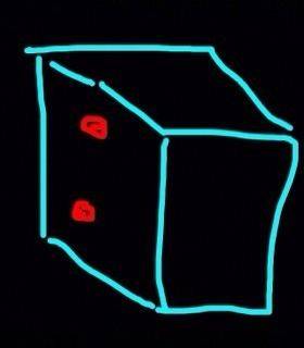

Here's the project:
You have a 60x60x60cm box, and a marble (the material of the marble could be steel, glass, plastic, etc.).
There are 2 holes in the side(s) of the box that are 20cm vertically apart.
The marble must start from the lower hole with basically no velocity, and by any non-electrical means shoot out of the upper hole.
How would you do it?
What kind of simple machines / devices would you use to propel the marble?I am doing this myself, but I am really interested in seeing what some people will come up with!
the red are the holes.

Haha, the two holes right above each other make this a lot trickier...
