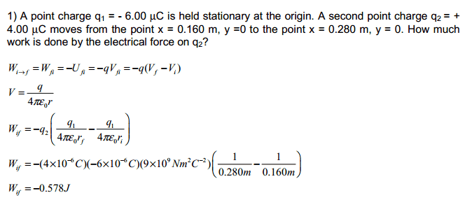

I just did a question on a charge moving relative to a stationary charge from an initial position x1 to a final position x2. I was under the impression that for questions involving coulombs law, and the equations for Electric Field Strength, Force and Potential we ignore any -ve signs on charges?
So after checking my answer I saw that I had the right magnitude but the wrong sign. The only thing I did differently was take the charge in my equation for the potential as 4μC instead of -4μC as can be seen on line 4 of the calculation below.
Any insight into this will be greatly appreciated!
