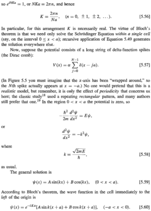

  • #63
@PeterDonis Do you agree that there exists an allowed value of k such that ##\psi=\sin(kx)## is an eigenstate of H, but not of D?
  • #64
Happiness said:
Do you agree that there exists an allowed value of ##k## such that ##\psi=\sin(kx)## is an eigenstate of H, but not of D?
Have you shown one in this discussion?

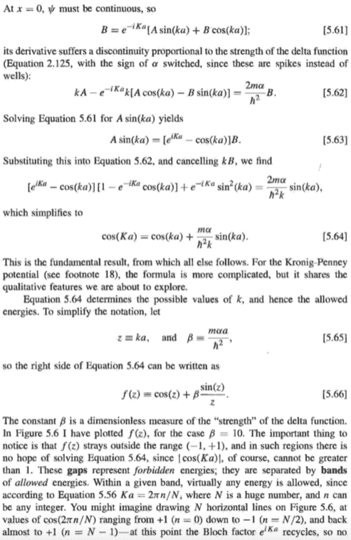

  • #65
Ok I didn't show an example explicitly as I thought B&J's paragraph following (4.190) is an adequate proof of what I have been saying.
Anyway, you can find one such example from Griffiths:

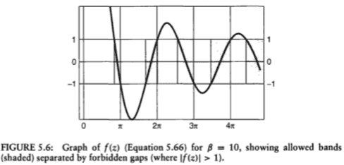

For each value of K in [5.56], we solve [5.64] graphically. For each K, we draw a horizontal line in Fig 5.6, and we may get several points of intersection. Each point corresponds to an allowed value of k. (K determines the value on the y axis; k is determined from the x coordinate of the point of intersection.) Each allowed k corresponds to two values of K, as you can see from [5.64] that if K is a solution for a particular k, then -K is also a solution (for the same k). Substitute the big K and small k that you get from a point of intersection into [5.63] to get A in terms of B. Substitute this A into [5.59], and after normalisation, we get a value of A and B that satisfy both [5.48] and [5.49] for an allowed value of k. (Actually, we get two values if you remember to include the case for -K.)
But for this allowed value of k, any A and B would have satisfied [5.48] (since k is the same means energy E is the same), but not [5.49].
Therefore, there exists an allowed value of k such that a solution to [5.48] is not a solution to [5.49].

What you said seems to contradict Griffiths's statement below:
Griffiths said states with energies in the gap region are physically impossible, but you said these states are physically relevant.
A definition of "growing mode" and "decaying mode" would be helpful, and also a concise explanation how they are "exponential".

[5.62] is used to search for common eigenstates of H and D, since it is obtained from the eigenvalue equations of H [5.48] and of D [5.49]. Therefore, not any A and B would satisfy e.g. [5.62]. Isn't it true that any A and B would satisfy [5.48] for a particular E since [5.59] is its general solution?
Cthugha said:
You then repeated the discussion in post #65 and made it more complicated.
The post is a response to PeterDonis's request for an example. It is not complicated. You may need some time to read it, yes, but it's not complicated.
