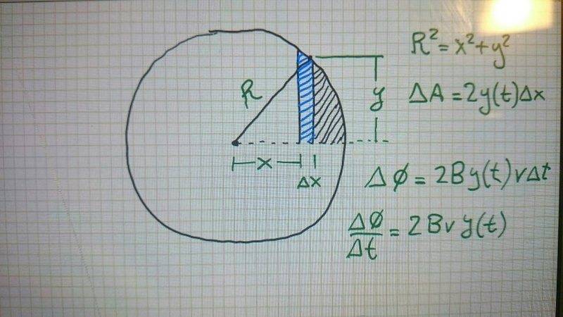

TSny said:
x = r cos(θ/2) where x is distance of center of ring from edge of field region and θ is subtended angle of effective length.
Ah..I see! I had written this equation earlier, don't know why I didn't contonue with that.
I'll work out the math later.
So Leffective=2rsinθ.
Which means motional emf=2Blvrsinθ.
This equation is sinusoidal w.r.t. the angle θ, but since θ doesn't vary linearly with time, the equation is not sinusoidal w.r.t. time. Is that correct?

The area exposed to magnetic field is much more than simple Sine function
Of course, but it's the rate of change of area that generates the emf.
What I mean is that rate of change area is not simple function of Sine
"Function of Sine" is meaningless. Do you mean it is not the sine function of the subtended angle?
The rate of change of area is the linear speed multiplied by chord length. The chord length is 2r sin(θ)
That's what try to mean,

Has anyone found a way to solve it yet though? I am quite certain you don't need to use calculus to solve this, but I am sure there are multiple valid methods one can use.
This problem needs trigonometry and some calculus (chain rule of differentiation).
The emf graph w.r.t. time is a part of an ellipse.
Read #23, #25, #28, #30 and #31..

That would probably work, but it seems like that would be more complicated than this really has to be. All the other problems in the textbook on induction have required far less complex methods than what you're describing. What i was thinking was to just find the average and max value for the emf in all the general positions. The problem doesen't really require us to represent all of the emf values induced with a graph, although I am sure its possible to solve the problem that way.
Then I guess they want you to find the voltage and current only at the 5 positions shown. Why else would they draw those 5 positions instead of just saying that the ring passes through the field with a constant velocity of 5m/s?
You can compute the emf at the given positions without calculus and any variable transformation. See TSny's pictorial hint in #2.
I think it would be helpful if you quoted the statement of the problem exactly as it was given to you. In the first post, you mention having to get the magnitude and direction of the induced current. Then in a later post, you mention having to get max, min, and average values of emf.
I wrote the whole problem statement i my first post. The problem is that they did not specify whether they wanted the current as a function of the time or just spesific values. However in the answer section for the problems in the very back of the textbook they used a max value as well as an average value as an answer to this specific problem.
So i was able to find the average value of the current for current for position 2. I found that the emf must be (((0.4T*pi*0.1m^2)/2)/20ms)/0.1Ω
This gave me 3.1A which apparently is the average current. However i do not really understand why that gave me the average current. Isnt the emf constant when part of the ring is in the magnetic field, then 0 when all of the ring is inside? Additionally, how do i go about finding the max value for the current?

The emf is never constant (except when it is 0).
Are you asked to find the average emf from position 1 to position 5?
Why isn't it constant when the speed is constant and the rate of change in area is constant?
The problem doesent specify, but based on the answers section were supposed to find the average and max values for each of the positions. However, positions 1,3 and 5 all have emf values of 0 (why is this?), so in reality only for positions 2 and 4.
Like i said the entire problem statement is in the first post, however the creators of the physics textbook were quite unclear in the way they formulated the problem. I am sure there is still a lot to learn through working with this though.
Area is not changing at a constant rate.

Are you still insisting that the induction is a sinusoidal function of time? Or do you now accept that the graph of it against time while crossing each wire is a half ellipse?

Did you try to get the increase of area (proportional to increase of flux) as a function of time? If you didn't see the picture maybe it will help you.
