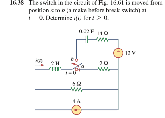

What is the initial voltage of the capacitor in this circuit?

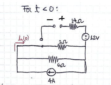

I would like to know the initial voltage across the capacitor terminals in the following diagram.
when a capacitor is connected to a DC source for a long time, it acts an open circuit.
for t < 0, we get the diagram below and I believe the voltage should be 12V right?
just making sure, because In an online solution it said the voltage is 0, if so why?
Thank you

Before t = 0 the circuit is open at b. How could charge flow into the capacitor?
but isn't one of the terminals of the capacitor connected to the 12V source?
while the other is just simply disconnected... shouldn't that incur a potential difference between the two plates
never mind sir, I get it... very silly mistake
thanks though
