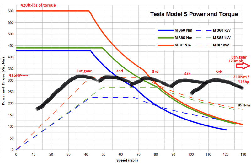

One of the problems of comparing performance of the electric Tesla and gas cars , is that the tesla only uses one gear ratio and a very broad HP curve. (forget about the flat torque and all the marketing hupla) its HP curve dies out at 130mph and past 80mph is pretty anemic . However, if it had just one more gear, (and here were versions in the past that did have 2 gears), it would be a high speed monster too, being able to take its 420hp engine , to near 180mph
I like this look at an actual tesla dyno run... It clearly shows its advantages and disadvantages over a comparable powered V8 gas engine.
what it shows it that the penciled HP curves vs the tesla dyno run, can actually make the same rear wheel torque initially (due to gearing) as the tesla... and it has power to use at much higher vehicle speeds.

  • #42
rcgldr said:
Not sure why this old thread was brought up again, but assuming that the Tesla motor is similar to typical DC motors, then the torque is greatest at zero rpm and linearly decreases to zero at maximum rpm. Peak horsepower occurs at 1/2 of peak rpm. To prevent wheel spin, the torque is limited to some maximum value, so you get a flat torque versus rpm curve until the maximum motor torque versus rpm decreases below that of the limited torque.
actually, most AC servo motors, as what is powering the Tesla has a flat torque curve, until the inductive losses start effecting current rise in the motor windings where the torque will fall off linearly.
as far as comparisons to a gas engine.. starting torque in most V8 cars can be as high or higher.. most of the time, its tire grip limiting for both car's power plants.
  • #43
The penciled in curve for an engine/transmission combo is incredibly closely geared, and doesn't really look right to me. 4th gear runs out at 85mph, and 5th at 110, which is pretty unreasonable for any high performance vehicle.
  • #44
Actually, its a 6 speed based on another dyno run. its safe to use a post shift RPM level to be about 75% of redline. with 1st gear redlining at 40mph or so, the rest is just simple math... yes, this would be a little close in gear ratio, but widening it up, to say 70% (pure street car ratios), wouldn't change things all that much.
The point seems to be clear, the gas engine has quite a bit of advantage passed 80mph and the same starting forces. the advantage the electric car has, is that it can be a closer performer, with similar max HP output, without a gear box. (only a single reduction)
  • #45
What car is that based on that has 300+hp, but runs out of gears with a 6 speed at 140mph? Even in a racecar, there are several tracks where that 6th would be a bit too short. I'd expect the gearing for a sleekish 300hp car to be more along the lines of (gear: speed at redline):
1: 40
2: 70
3: 95
4:115
5: 145
6: 170
1: 40
2: 70
3: 95
4:115
5: 145
6: 170
you are too focused on the micro details of the graph. sure, its not a realistic spread as I worked backward with a close ratio gear box , more like a 7 speed.
the point is, your gear ratios are not too viable either.
most 6 speeds look like this:
8:1 1st
7:1 2nd
6.:1 3rd
5.:1 4th
4:1 5th
3:1 6th
this is a 80-75% drop (apprx) per gear.
regardless, you can see the average HP that is kept pretty consistent out to redline. that's the point. the tesla has a flat HP curve, which is ideal for wide spacing in gears , or in its case, NO GEARS. :)
  • #47
You should let Porsche know - those are very close to the ratios in my 6 speed box in my Cayman S...
  • #48
I thought those were gear ratios, not speeds in gears as they are. yes, they are normal.
regardless of the actual rations, its the space you need to look at and if you do, you can see that the ratios I posted are very close to your ratios as well.
So, the point is, with 6 speeds its easy to keep the car in the HP range to have max acceleration potential at any speed. (proportional to the power, as acceleration is)
again, the Tesla has a broad HP curve, which eliminates the need many gears. 2 gears would keep it on par with most cars... 1 gear as it has now however, loses a lot of acceleration perforamance after 80mph.

SteamKing said:
It's not clear for what sort of gearbox these ratios are intended. For automotive use, the fourth or fifth gear is typically a 1:1 ratio, with the higher gears (5th or 6th) typically being overdrives (that is, the gear ratio is less than 1). Of course, the final drive ratio in the differential also must be factored into give the true ratio between engine speed and wheel speed.
Its very clear... I've given you the overall ratios. you can make up any combination of rear end to transmission as you would like and it doesn't matter if 4th gear is 1:1 or 2:1, or .5 :1.
actually, Porsche has a lot of cars with 1:1 happening in 4th... as in my race car. :) you might want to talk to porsche about that. :)
so, fine, let's use your ratios.. it doesn't matter . I just picked some general close ratio numbers. your very nice Porsche street ratios are pretty close, at .57, .73, .and the rest are over .8 (post shift) RPM values vs redline
again, ratios do not matter.. the point is the gears keep the engine in the max HP range which is essential for maximzing acceleration at any speed.
