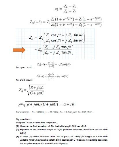

I have tried divide input impedance for transmission line based on RLGC value divided to N, and take into Zin function, but cannot go ahead.
I do not find any reference showing what is the math relation for total Zin and each parts of Zin.
to be brief:
(1) if we divide transmission line with N equal parts, we could obtain each parts of transmission line by simple divide total RLGC by N? am I correct?
(2) if I have N parts of transmission line with different length(different RLGC), how could we obtain total RLGC? can we add them together?
we can start with simple equation from short and open load as listed in the attached file.
Thanks very much!
total with L, Zin=Z0cot(Belta*L) ,
each part with length equal to L/N, Zin(i)= Z0*cot(Belta*L/(N^2)). i=1,2....N
Not sure if could obtain Zin=Z1+Z2+......Zn
Here I list my problem in the attachment.

The question is not clear but I'm guessing the OP wants ##Z_{in}## for different lengths.
I'm no expert but we have (from the Post #1 attachment)$$Z_{in} = Z_0 \left( \frac {Z_L + jZ_O \tan βℓ}{Z_O + jZ_L \tan βℓ} \right)$$The relationship between input impedance and length (given all other parameters are the same) is quite complicated.$$Z_{in}(ℓ=L_0) = Z_0 \left( \frac {Z_L + jZ_O \tan βL_0}{Z_O + jZ_L \tan βL_0} \right)$$ $$Z_{in}(ℓ=\frac {L_0}N) = Z_0 \left( \frac {Z_L + jZ_O \tan β\frac {L_0}N}{Z_O + jZ_L \tan β\frac {L_0}N} \right)$$ $$Z_{in}(ℓ=NL_0) = Z_0 \left( \frac {Z_L + jZ_O \tan βNL_0}{Z_O + jZ_L \tan βNL_0} \right)$$Edited.

I re-think my problem and try to make clear below:
(1) what Steve supplied is correct, but I I would like to know more for different parts within a transmission line, for example, the total lengh L being divided by N parts, their impedance Z(i),i=1,.2..3...N is not independent, each Z(i) has its locations. So I want to find equation for Z(in) that has location variables, only become this we could integrate together to obtain total impedance for the whole line(length= L).
it may be clear to see the below table.
first row is imput impedance for three parts.
second row is supposed for equal divide of Δx.
Third row is supposed for non equal divident.
Second row and third row may have different length in total(just an example).
Z0Z1(x1)Z2(x2)Z3(x3)
location at zero point,x0=0x1=x0+Δxx2=x1+Δxx3=x2+Δx
x0=0x1=x0+Δyx2=x1+2*Δyx3=x2+3*Δy
if we integrate z0 to z3 for the second row with equal divident that seems ok.(also not sure)
if we integrate z0 to z3 for third row, that might be different:
a1) integrate z0,z1,z2,z3
a2) integrate z1,z3,z2,z0.
(2) it would be quite different to obtatin imput impedance If I place one same short connector between z1 and z2, or between z2 and z3.
so if I make clear of the equations for divided parts, I would see through total z from frequence domain to know what is wrong with my connections.(I know we could employ time domain analysis by numerical computation, but the above idea could see from RLGC to build the total transmission, and inteprete more information----problems from R,L,G,C.... )
To add more, input impedance is both length and frequency dependent. so I guess if we exchange location for divided parts, we got different results in whole frequency band.

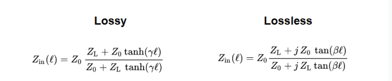

Sorry to say, as I suppose we could divide and integrate the transmission lines, it is a lossy line not lossless line, so the input impedance equation would be little changed.

How about this:$$Z_{in} = Z_0 \left( \frac {Z_L + jZ_0 \tan βℓ}{Z_0 + jZ_L \tan βℓ} \right)$$Suppose we have N sections of transmssion line. The i-th section, considered in isolation with its load ##Z_{L,i}## has impedance:$$Z_{in,i} = Z_{0,i} \left( \frac {Z_{L,i} + jZ_{0,i} \tan β_i iℓ_i}{Z_{0,i} + jZ_{L,i} \tan β_i ℓ_i} \right)$$The load impedance of the i-th section is the input impedance of the sections following i-th section. We can use an iterative approach a build-up the overall value of ##Z_{in}##.
a) Calculate ##Z_{in, N}## (the input impedance for the last section).
b) Calculate ##Z_{in, N-1}## taking ##Z_{L,N-1} = Z_{in,N}## (giving the input impedance for last 2 sections).
c) Calculate ##Z_{in, N-2}## taking ##Z_{L,N-2} = Z_{in,N-1}## (giving the input impedance for last 3 sections).
etc.
Eventually you find ##Z_{in,1}## which is the required overall impedance.
Trying to combine the above steps into a single algebraic equation would be unmanageable. But for numerical calculation purposes, a simple computer program would be quite practical.
