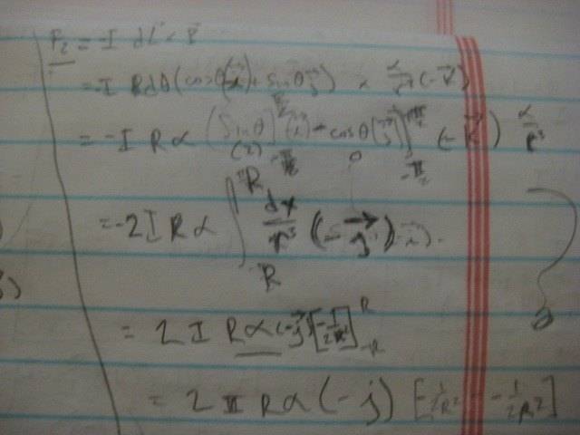

I can't seem to integrate this correctly. I only need the half loop integration, as i have the correct integration for the infinite lines.
We start with the top half of a half-loop of radius R, centered at the origin, with infinite line segments traveling in the +/- x directions.
B=\frac{a}{r^3} (-\vec{k} )
and
r=\sqrt{x^2+y^2}
dF=I (dL x B)
My attempt at a solution ends up with me getting confused over how to determine the resultant vector by cross product.
I(dLxB)
<br /> =I Rd\theta (-cos\theta(-\vec{\i})-sin\theta(-\vec{\j})) \times \frac {a}{r^3} (-\vec{k} )<br />
now, d\theta = \pi, and
I integrate \int_{-\pi /2}^{\pi/2}(-cos\theta(-\vec{i})-sin\theta(-\vec{j})
which results in
\int_{-\pi /2}^{\pi/2}(-cos\theta(-\vec{i})-\int_{-\pi /2}^{\pi/2}(sin\theta(-\vec{j})
\left[(-sin\theta(-\vec{i}) \right]_{-\pi /2}^{\pi/2}+\left[(cos\theta(-\vec{j})\right]_{-\pi /2}^{\pi/2}
yielding 2+0=2
I then integrate 2\pi IRa \int_{-R}^{R} \frac{dx}{x^3}
but my final result ends up being
=2IR\pi a [\frac{-1}{2R^2}-\frac{-1}{2R^2}] which is zero and I need it to be one.
Also, I believe the correct answer is
\frac{2Ia}{R^2}(-\vec{j}) which does not have the RΠ factor which I end up with...
Can someone please help me comprehend this better, as it has been many years since I have had calculus and haven't been able to find any examples of this type of integration.
Thank you very much!
here are some pics
here are the pictures of my problem and, seemingly, my result.
