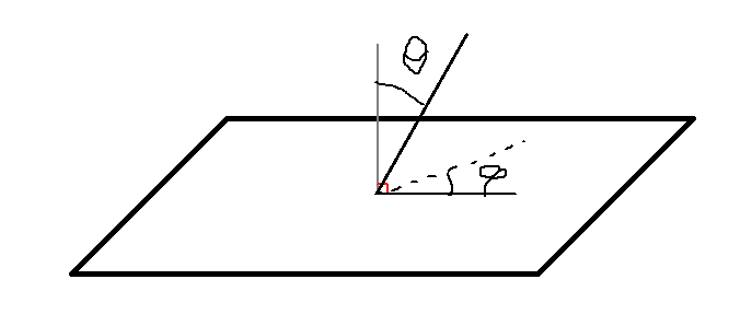

Suppose I have a relation [itex]S(\theta, \phi) = U \frac{c}{2} \cos{^{2} \, \theta} [/itex] and I want to integrate over [itex]\phi[/itex] from [itex] 0 [/itex] to [itex] 2 \pi [/itex] and [itex] \theta [/itex] from [itex] 0 [/itex] to [itex] \frac{\pi}{2} [/itex]. How do I do this double integral? Do I just do it normally (without any transformation), or do I use a total angle? I know that I'm supposed to get [itex] S = U \frac{c}{4} [/itex] but I'm not sure how it works.
Here's an image I made:
Angles are a little confusing for me so I would like some feedback.

What you have literally stated as the problem is to find ##\int_{\phi=0}^{2\pi} \int_{\theta=0}^{\pi/2} U \frac{c}{2} \cos{^{2} \, \theta} d\theta d\phi##. But that isn't going to give the desired answer.
What you mean, I suspect, is that you want to integrate over a surface parameterised by those angles. In that case you need to include the Jacobian. This represents the area of an element dA in terms of small changes in the two angles. See e.g. http://en.wikipedia.org/wiki/Spheri..._and_differentiation_in_spherical_coordinates.
(But make sure you get your θ and ϕ the right way around. Not everyone uses the same notation.)

Integrating over the angles doesn't take any regard of the fact that they are angles. it just treats them as arbitrary variables of integration. ∫∫(function)dθdϕ.
Integrating over a surface means ∫(function)dA, where dA is an element of area. In spherical polar, dA = r2 sin(θ)dθdϕ, where θ is the polar angle and ϕ is the azimuthal angle (which is the way you have used them).
