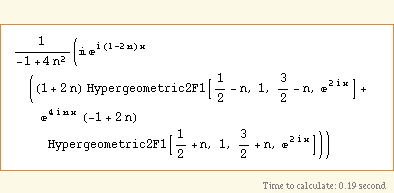

\int\frac{\sin(2nx)}{\sin(x)}dx
Here n=1,2,3...
I think that i should get any way to represent \sin(2nx) as product of sinx and something. But i don't know how.
Thank you
Except for the integration constant,here's what Mathematica gives as an answer.
Daniel.
