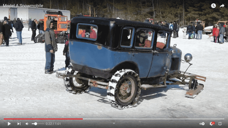

Someone appears to have wrapped track pieces around the wheel of a Model A Ford and made a snowmobile. Is this actually effective?

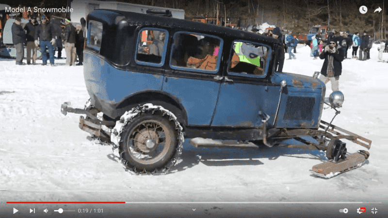

Attached are photos of a Ford Model A snowmobile. The owner wrapped track pieces around the rear wheels, but it does not appear to have a bogie or other track drive system. Does this setup look like it is really effective as a tracked machine?
  • Blue and black 1930s Ford Model A sedan converted to a snowmobile, with track sections wrapped around its rear wheels and skis at the front, parked on snow with spectators in the background.
  • Blue vintage Ford Model A sedan converted to a snowmobile, driving on snow with chains on its rear wheel and a ski on the front.
Well, it's a heck of a lot more effective than plain tires, so what's your issue?
The engine might not be as strong as modern engines meaning it might get stuck in some circumstances but otherwise it looks awesome.
I don't have an issue at all! I just want to build one for myself, and I'm trying to figure out if the tracks around the wheels still works like a traditional track system. That is all. :)
As long as they are put on tightly enough so as to no slip they should.

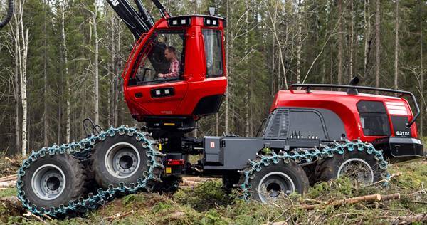

The obvious limitation with this vs a full track is contact area.
Not really their idea and there are even more serious ones.
3D render of two rubber tires on metal rims, each wrapped in a blue track with lugs, forming a tracked wheel assembly on a white background.
Red forestry harvester machine with a cab and crane arm, fitted with chains on its eight wheels, working on a forest floor with tree trunks and a man visible in the cab.
Here, get one of these. . . . 😏
... Does this setup look like it is really effective as a tracked machine?
That will depend on what you want it to do. Effective at what?
1. To increase traction on a surface that fills normal tyre tread, like snow on hard flat ice. Tire chains are more flexible and will cause less damage to the road tyre.
2. To get traction on black ice. Tyre studs will work better on hard ice since the very high point pressure crushes the ice.
3. By increasing the ground contact area, to prevent sinking up to the axles in deep mud or snow. Bulldozer like tracks, rubber tracks on a skid-steer, or a snowmobile belt, work better since they span between axles, so have a greater area, with a very much lower ground loading.
4. To increase the tyre contact patch, so more traction force is possible before the soil or snow immediately under the wheel shears, and the wheel bogs.
5. Providing protection to the tire from thorns, stakes, or from sharp spikes in the ground, such as cut or burnt bush roots. For that the track plates need to overlap like fish scales.

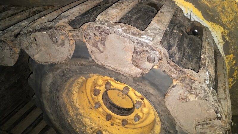

Having experience on a skid loader with steel tracks wrapped around each side I can tell you they're not a magic bullet. They look very similar to the tracks in post #9 but the rails do not have little studs sticking up. They never did, it's not an issue of being worn off. In snow they are awful. If the machine gets sideways on a hill it will slide all the way to the bottom. In soft swampy ground they are the real ticket. The tracks that span between the wheels help hold the machine up in soft ground. I hate taking them on and off. A custom made tool for stretching them on has helped but I still hate doing it.
BTW, concerning protection from tire damage, they are more trouble than they are worth. If a person puts tracks like that on something I would recommend having the tires filled with foam.

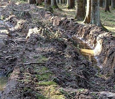

They are not only about allowing the vehicle traverse in some difficult terrains: their secondary purpose is to limit the erosion.
Photo of a muddy forest track with deep parallel ruts cut into dark soil, water pooling in one rut, scattered branches and moss, and tree trunks along the edge.
@Baluncore I wonder if you have ANY actual experience with foam filled tires. My original statement was that on a skid loader with tracks wrapped around the tires in a setup similar to a pic in post #9 tracks can be more trouble than they are worth without foam in the tires. It's way too much trouble to repair a tire from a puncture. Never did I say foam is a magic bullet in any tire anywhere. But I can tell you that they can still run with parts of the tire literally missing.
https://images.app.goo.gl/bmWd4QtwCT5Gdy539
I do, but I do not need them on my skid-steer loader since it is ballasted with tire sealant.
For your situation foam fill is obviously an excellent solution.
And I'm assuming it doesn't have tracks. Putting foam in is an expensive way to go if not necessary. In my case I don't get into enough hardware to warrant foam on its own. But with tracks, I wouldn't have it any other way. Just too much trouble to fix a tire with tracks on.
For anyone who's interested, here's a close-up:View attachment 295300
Thank you for the picture! Here's what I do not understand (forgive me for sounding ignorant!) - the track wraps around the tire like a chain, but is its tread pattern anything resembling a track - because it still looks circular.
Mgt3 said:
... the track wraps around the tire like a chain, but is its tread pattern anything resembling a track - because it still looks circular.
The one track wraps around two wheels on one side.
The part between the wheels looks like a track.
Look at the dark area in the bottom left corner of the picture.
Ah, okay! Thanks. I didn't think it could be done with one wheel.
