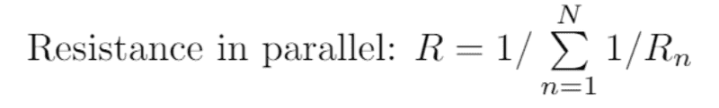

I am creating an equations sheet for electronics forumlas and am wondering if it is OK to write the equation for resistance in parallel like this:
TBert said:
I am creating an equations sheet for electronics forumlas and am wondering if it is OK to write the equation for resistance in parallel like this: View attachment 197492
Yes.
My memory rhyme was always "Reciprocal of the sum of the reciprocals"
which when pocket calculators came along in 1970's became quite handy.
Enter R,, press 1/x, press M+, repeat until all R's accounted for, press Recall Memory, press 1/x .
That's one place where a pocket calculator really outdoes a slide rule .
Your formula is much more elegant. Just make sure there's not a R0 !
have fun,.
old jim
Likes Electron Spin
A bit off track but in // r's the total network R should always be smaller than the smallest resistor in ohms.
Also, a network has no P/S whereas a circuit has a power supply.
And again what Jimbo said... R total = the sum of the reciprocals, reciprocated. You can use the same formula for inductors as well, whereas capacitors you treat opposite.
