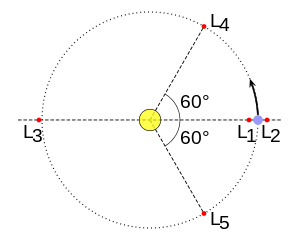

If you introduce a third massive body, that both M and m are orbiting, then you can get a class of solutions that is close to what you're asking for. Namely, M and m can follow one another as they orbit the central mass. In this case, the body m is at all times under the gravitational influence of M, as well as the central mass, so it can be said that it is trailing M.
These solutions are called the Lagrangian points.
(the blue blob representing M, the red dot m)
Of these five points, only L4 and L5 are stable.
To reiterate, if by trailing you mean being affected by the gravity of another body but neither obiting it nor changing the distance to it, then L4 and L5 should do.
