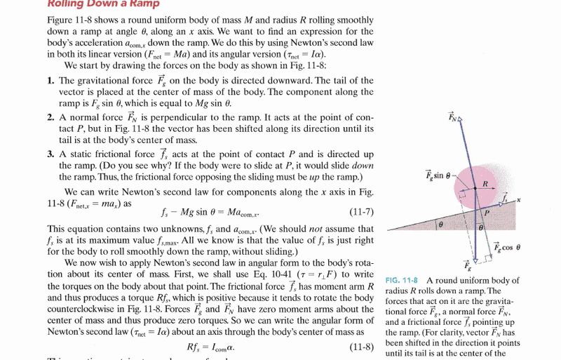

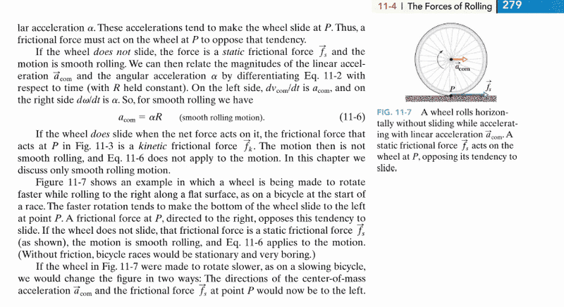

In Chapter 11, section 11-4, subsection friction and rolling, it is stated that the static frictional force is along the same direction as the direction of motion because the point of contact of the wheel with the floor is moving in the opposite direction. Then, in the next subsection, the same situation but with an inclined plane is discussed, yet now the frictional force is opposing the direction of motion. Could someone please clarify this issue for me?

The force of friction acts in the direction of motion of the surfaces in contact not the direction of motion of the whole object. In case of the bicycle the wheel in contact with the ground is moving opposite the bicycle motion whereas for the inclined plane the block and its contact surface are moving in the same direction.
Oops the force of friction acts in the opposite direction of the moving surface.
I've attached the relevant sections. Please read them and clarify the misunderstanding

Figure 11-7 isn't a complete free body diagram because there is no indication of a force that would cause the wheel to accelerate to the right. Assuming the wheel is a bicycle wheel we could draw an "applied torque" at the center of the wheel, but we could also imagine the torque is supplied by an applied force acting at point P. To give the applied torque the proper direction, this applied force would act to the left. The direction of the frictional force opposes the applied force.
In Figure 11-8 , if you change the problem so the wheel is a bicycle wheel and a cyclist is trying to accelerate down the incline plane, then we can imagine that the the torque of the cyclist is produced by a force acting at P and pointing up the plane. In that case friction would act to oppose that force and it would point down the plane. In the problem showing in figure 11-8, there is no applied torque besides the frictional force and to explain the sense of rotation of the wheel, we have to point the force of friction up the plane.
As to whether those figures are inconsistent with the words in the text, it's hard to say. (We don't see all of them!). I don't find it easy to apply the concept that "the direction of friction opposes the direction of slipping" when slipping would imply "standing still" as in figure 11-7.
