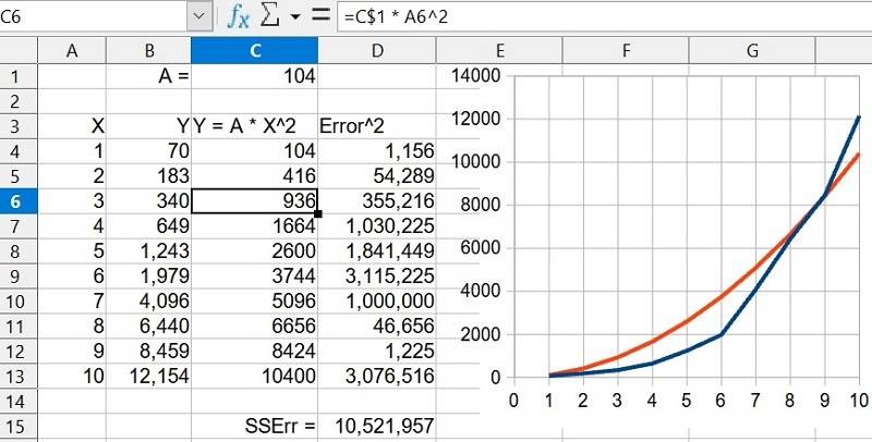

When curve fitting, I normally use a spreadsheet to find the mathematical curve. Excel has a good solver, but LibreOffice does not, so I use a manual gradient search to minimize the sum squared error. I also like to plot the mathematical curve on top of the experimental data. An example quadratic fit for the data in the OP:

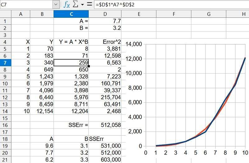

I next tried an equation of the form ##Y = A*X^n##, where both A and n are variables. This one has two variables, so it took about ten minutes to iterate both A and n. The optimal approach is to choose a value for n, then iterate A for minimum sum square error (SSErr in spreadsheet). Choose a new n, repeat. The results:
The table in rows 18 to 21 shows the effect of iterating the exponent. It would be easy to get another decimal place of accuracy in the exponent, but the resulting decrease in error would be minimal. I also see no need to add additional terms to this equation.
The same approach is easily adaptable to exponential, trigonometric, or other forms. Although more than two variables can be challenging to curve fit by manual methods. I like this method because I have direct visual evidence of the quality of the curve fit, it can be done with any spreadsheet, and it's easy.

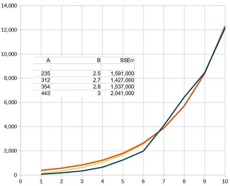

I tried an exponential function on the data in the OP, ##Y = Ae^{X/B}##. That did not fit well, so I subtracted the A value: ##Y = -A + Ae^{X/B}## to force the equation to start at 0, 0. The optimized results of both of these equations are plotted below.
Summarizing the equations and sum of square errors for the above curve fits:
Equation ... SSError
##Y = X^2## ... ... 10,522,000
## Y = AX^n## ... ... 512,000
##Y = Ae^{X/B}##... 2,191,000
##Y = -A + Ae^{X/B}##... 1,427,000
It looks like the polynomial of degree 3.2 is by far the best fit.
But simple curve fitting is (usually) not the best way to fit curves to data. The best way is to start by looking for the math underlying the original data. If the original data is from population growth with exponential basis, then the curve fit should be exponential, even if a polynomial would better fit the data.

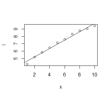

I agree. That would be my first recommendation.
Here is what I got from an R program:
Residuals:
Min 1Q Median 3Q Max
-0.39081 -0.11329 0.07758 0.14110 0.26229
Coefficients:
Estimate Std. Error t value
(Intercept) 4.06994 0.16508 24.65
x 0.56936 0.02661 21.40
Pr(>|t|)
(Intercept) 7.83e-09 ***
x 2.39e-08 ***
Signif. codes:
0 ‘***’ 0.001 ‘**’ 0.01 ‘*’ 0.05 ‘.’ 0.1 ‘ ’ 1
Residual standard error: 0.2417 on 8 degrees of freedom
Multiple R-squared: 0.9828, Adjusted R-squared: 0.9807
F-statistic: 458 on 1 and 8 DF, p-value: 2.392e-08
