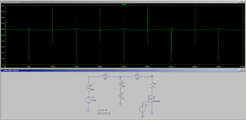

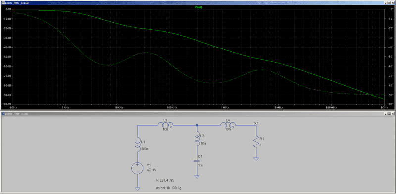

I'm trying to set up a DC power supply filter for a 2kW motor controller. I'm trying to set up inductance cancelling for the input capacitor array. When I simulate the coupled T filter in the frequency domain I get what I expect to see. However when I simulate the transient response I'm still getting voltage spikes due to input capacitor ESL. I'm not understanding why the filter is failing to attenuate those. Can someone please explain to me what's happening? See attached plots below.
TIA,
- Craig
Looks like you need a snubber on the output, a series R-C probably slightly over damped. Connect from output to ground if you are worried about spikes in the load, but they are typically needed across the Transistor for protection, especially for an inductive load.
As it stands, probably the T-filter is resonating with the Transistor output capacitance. In the real world there will also be the stray capacitance of both the wiring and the inductors. Also, if you haven't already, consider the 200nH source inductance.

I actually figured out why the coupled T-filter doesn't work for me in this case. Turns out unlike a typical shunt capacitor it only filters the supply side. It does work in an excellent manner by cancelling ESL on the supply side, but does not do the same job on the output side. If anything it increases output reactance. Spent a lot of time trying to understand that filter and got kind of frustrated though I think I get it now. It's pretty trick but limited in application.
Yeah I'm running snubbers at the drain-source of each transistor which cleans up some of the noise. Otherwise I'm running an array of MLCCs at each of the half bridges shunting the the high and low side (it's a BLDC controller). Doing that Introduces minimal parasitic ESL and gets voltage spikes within tolerance. Not perfect but pretty good. The plus side is I can bail on using large bulk capacitors that are tricky with high currents and their higher ESL.

Spent a lot of time looking and that was the best I found. If noise is on the supply side that filter does an amazing job killing off those inductive effects. Just too bad I could not find or think of a way to get it to cover heavy load switching from the output side. Believe me I tried all kinds of iterations via simulation inserting coupled inductors here or there and could not find a way to do it. Actually I did find a way, but it's necessary to couple the parasitic inductance of the capacitor with the inductor on the output side of the T. Works great in simulation, actually cancels inductance on all three legs, but it's not something you could physically do. There's no way to couple inductance that's originating from inside the capacitor.

Looking at the waveforms you posted, it seems that the ringing is under damped. Little hard to tell with that resolution though. Of course when it's built everything will change anyhow!
Yeah you do have to take simulations with a grain of salt. Though they're usually not completely off either. I actually went to the trouble of making a couple nice screen captures, but the forum reduced the images and they lost a lot of resolution. Anyway it was just a quick circuit I drew up to demonstrate what I was talking about. Here's a screenshot of the actual one I'm checking things with, this is posted on my personal space where it won't lose resolution; http://webpages.charter.net/chblock/BLDC_controller.png .
