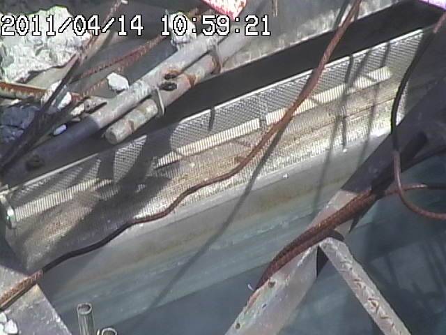

Krikkosnack said:
Fuel Rods of the reactor 4... are really those?
http://www.houseoffoust.com/fukushima/rods.html
The limited resolution of the available photos do not make it feasible to 'find' any individual fuel rods.
Perhaps you mean looking for fuel rod _assemblies_.
If I have it right, assemblies would in a BWR -- complete with cladding -- be rather large square sticks, about 4.5 meters long and about 0.14 meter wide -- and that's within the resolution of at least some of these photos. I am not an expert, but I would expect these assembles sticks to be found with a brownish color (unless oxidized, when I think they might form a whitish oxide crust)
For size comparisons some of the roof material scattered everywhere comes handy.
The roof 'strips' shown here are from unit 4, and are about 7 m long and about 0.7 m wide. Roof strips from unit 1 and 3 are about the same length, but only half as wide. So good hunting.

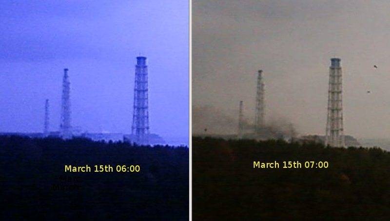

clancy688 said:
Doesn't it look like as if there's white smoke coming from the eastern (sea) side of unit 4?
Indeed it does, and I've thought of that too.
The zoomout (see attachment) precludes that we are just looking at bits of a passing cloud. Then comes the illusion that the 'secondary' smoke fan could originate from further away, to the northwest there seemingly coming out of the forest on the hillside, but that _is_ just an illusion, the smoke-like tint there is not smoke, it is grey stuff on the ground thrown there by the explosion a few minutes earlier.
So, it certainly looks as if there is smoke coming from unit 4. I'll offer an alternative explanation in that the steam explosion at unit 3 threw out several large and steaming, hot objects. One of them may have landed in the yard between unit 3 and 4, and the smoke still coming from that could be what gives an illusion of smoke coming from unit 4.

Astronuc said:
WNN - Most fuel in Fukushima 4 pool undamaged
http://www.world-nuclear-news.org/RS-Most_fuel_in_Fukushima_4_pool_undamaged-1404117.html
14 April 2011
Which, perhaps surprisingly, is consistent with the imagery, IMO.

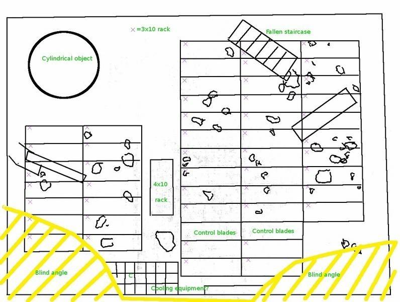

yep elevator is human service, as you can see remains on the roof tops of unit 1.
I'm not convince the location is the same (N/W) for unit 4, I think I could be S/W.
Also I'm not convince that there is a temporary cast pool, sofar I'm voting for cast operation handled in the main SFP.
I believe the is an un accounted for crane structure above the utility pool adjacent to the reactor "opening" on unit 4
what is the truck size whit object at the bottom south of the west wall..
there is a fair amount of roof structure debrit on the south part of unit 4 where do they come from, the south part of the roof does not seems missing that many parts.
