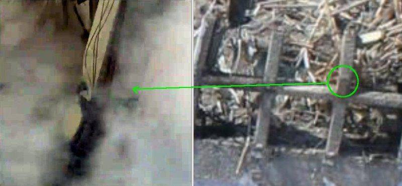

clancy688 said:
I have no clue how these damages [to unit 4] could have come from inside.
Looking at the latest drone video, it seems that the rebar in the outer concrete shell happens to be anchored and segmented in such a way that the internal explosion ripped the bottom and sides of each "panel" more easily than the top side. Therefore several panels remained attached at the top, like curtains. Apparently they opened out and up during the explosion, then fell back, swinging into the building, only to remain trapped there by the rebar.
This mechanism may explain the paradox of several #4 panels that seem to have been pushed inwards. It also fits with the state of the North wall. There, some panels of the second row from the top detached completely from the wall but remained attached to the panels above them.
By some mechanism that I cannot fathom, the topmost horizontal concrete beam on the North face was pushed (or pulled?) inwards, while the concrete beam below it was pushed and bent outwards. Thus the concrete panels in the second row of the North face were left dangling in the air, a couple of feet away from the building.

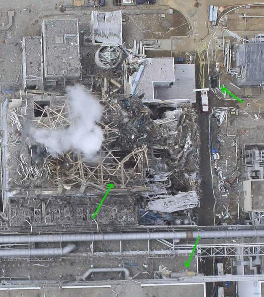

TCups said:
The explosion rips off the roof from the southeast corner, The expanding gas from the explosion continues to lift the roof slab off of the girders and billow it like a sail full of air, the weight of the what is left of the roof slab is borne by the north wall of the building. It begins to fall back into the building, dragging part of the north wall inward and downward (D)
Makes me go mmm.
looking at your figure D, I understand that you think that falling back , the former north edge of roof tar slided in the building, that the sail broke and while some of the roor tar had cut and slide the rest broke and went away some how.
Most of the roof tar is in my opinion between the turbine building and the east wall.
but above the line o breakage of the sail of the stabbing tar is not consistent with what I'm seeing: the rising edge sticking out is too perfect , rectiline; for me it is the former northern edge of the building roof tar; and if so .. The bending does not fit your theories as I understood it.
if anything I'll would rather think for now that the bended slided in tar is a consequence of the roof giving down and in.
Maybe someone with a camera or audio recording equipment captured the sound but not the explosion, maybe at a different location, and the two sources were thrown together.
In deed, as for the rest my opinion stand
Ya think maybe installing spring loaded hinges on the side panels to allow them to swing open then close again would prevent so many flying objects?

NUCENG said:
I agree with everything you say but if you eliminate hydrogen from SFP4 what is left? However improbable, and to date unproveable, it had to come from an external explosion. The initial report of the explosion talked of "an explosion inside the facility" and then they found damage to unit 4. It doesn't sound to me like they knew for certain that the explosion was inside unit 4. Your guess is as good as mine.
looking at the sources (digitalglobe pics, drone video) already posted, i can not imagine any outside source for the damage in #4.
the most damage is on the south side, opposite of #3.
you can see rebar bended outside on all 4 sides of the building.
the damage on the north side doesn't look like an impact as well, rather as if the pillars had been knocked of quite low from the inside, then the roof went inwards.
maybe (though i don't vote for that) it is possible, that something from outside had triggered the explosion in #4, but most of the damage has been done from the inside.
it's hard to tell, what is #3 and what is #4 from the angle of the webcam, but it looks like, that there has been lot of black smoke, when #4 exploded (even an hour after the explosion): (at 2:24)
fires have been reported, but i can't find any soot.
btw: i would estimate the mass of the roof quite low, iron sheets with tarboard, not likely to cause much damage (to concrete pillars) when coming down from a short flight.
what exploded in #4?
hydrogen released by zircaloy oxidation?
would require a dry pool, water spray started days after the explosion -> not possible
steam explosion?
i have not found any reference to this possible risk anywhere in the literature. were all the engineers that did the risk analysis wrong? rather not -> quite unlikely
acetylen?
can't tell, but has been rebutted in this forum -> unlikely
what else is left:
hydrogen generated by radiation?
hydrogen generated in steam bubbles at the bottom of the fuel?
both unlikely (the 'steam explosion' argument is valid for both).
i am running out of ideas
anyone?
