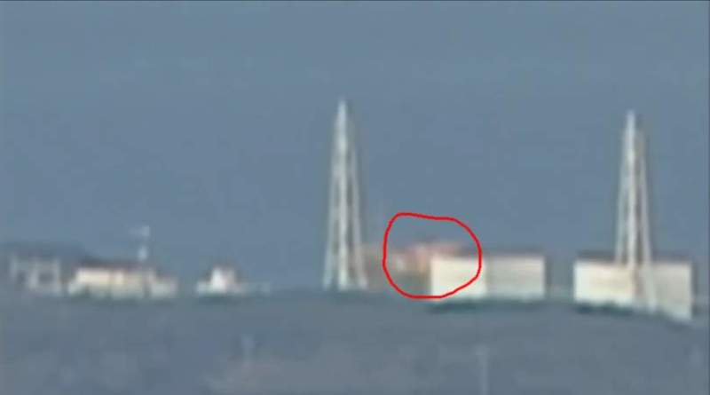

StrangeBeauty said:
What were they trying to do in unit #4 before it exploded/burned and after #3 exploded? In this picture, #3 has exploded, #4 has not, but I do not see the truck halfway into the access bay where they load/unload fuel and other supplies for the building:
http://www.digitalglobe.com/downloads/featured_images/japan_earthquaketsu_fukushima_daiichi_march14_2011_dg.jpg
Am I missing it? The truck is clearly visible in all subsequent overhead pictures of #4 after it burned/exploded:
http://cryptome.org/eyeball/daiichi-npp/pict12.jpg
Also I wish people would abandon the idea that there is any good data in the soundtrack of the video of #3 exploding that has the 3 added (and heavily processed) explosion sounds -- it's clearly faked (for many reasons previously stated here). Here's another one with faked added sound:
Here is a "guess" about the truck:
If the truck had been parked out back, and if it was contaminated from radioactive waste and needed to be cleared from the roadway behind the building (as in subsequent pictures), then perhaps the quick solution was to back it into the concrete tunnel, out of the way.
While it is likely that the sound track was indeed re-synched to the video for broadcast purposes, I doubt that anyone went to great lengths to "fake" what was originally on the sound track before it was synched to the video. Do you have any strong evidence to the contrary?

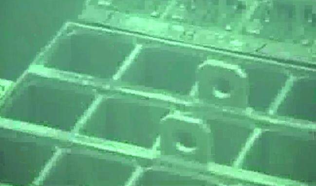

If operators were able to get close enough to the pool to take a sample it must be well short of boiling.
They took the sample with a bucket suspended from the concrete pump by a cable. The camera was mounted on the crane too. Radiation presumably was a bigger obstacle to human intervention than any heat level would be.

As to evidence that this is faked:
1) The explosion video appeared first without sound. I originally saw this on BBC with no sound.
(OK, so?)
2) The sound is mis-synced by a completely wrong amount. The camera was miles away and the sound should have been delayed by 10+ seconds (2 miles -- probably much more).
(I believe the speed of sound in air at sea level is 343.2 m/s, so 10 seconds would br 3.43 K or 2.1 miles, probably not much more)
3) The sound has way too many high frequencies for the distance. Think about what thunder sounds like close up, versus far away.
(the attenuation over distance would be log-rhythmic if my rudimentary understanding of dB is correct, and the "amount" would be dependent on the absolute amplitude of the initial sound, frequency, and the sensitivity of the recording device, and perhaps the graphic equalization used on the playback audio. Accentuation of the higher frequencies on replay ≠ "fake")
4) The second explosion sound is louder than the first even though no evidence of a greater explosion is seen on the video. The third explosion sound is also louder. Just look at it in any sound editing tool (e.g. audacity) -- (see attached)
5) There is nothing visible corresponding to the third explosion (or the second)
(sound waves are seldom visible, in my novice experience, but again, I thought I saw two components to the blast -- but as we know, I have been wrong before)
6) "news" organizations often juice things up to make it more sensational. See the second video with completely different sound track in my previous post.
(again, juicing up the audio and adjusting volume and frequency of the playback of a sound track ≠ fake soundtrack. In fact, I believe it is routinely done in forensic analysis.)
7) This sort of sound replacement is simple to add later. 5-10 minutes work at most.
(Are you suggesting they just lifted an explosion sound track from some other audio stock file instead of doing the same work with the un-edited sound track of the actual event? If so, then that of course would be fakery and fraud.)
8) To my ear, the three explosions are actually the same explosion sound source with slightly different processing.
(forget your ear, sir, what does the technical audio processing tell you? You have done the technical audio processing, right?)
fyi I have a background in professional sound production (amongst other things).
(excellent, sir)
Which is the healthier skepticism? Presuming something is a "fake" intended to willfully deceive or presuming until proven otherwise that it is not. Thanks, though for your opinion. Here's a bit more evidence, based on another member who posted here earlier on this very subject -- technical analysis of the sound track. You may or may not have read M. Bachmeir's earlier posts.
Mike summarized his opinion of the sound track in an earlier, private email to me, along with at least 20 different graphics and several re-synched versions. With due respect and credit to Mike, I will quote his email in part:
"in summary, there's evidence the video was cut. There's evidence the audio was adjusted. There's no evidence I can find of clipping, merging, or outright faking. Just bad use of out-of-the-box tools for syncing (in a hurry to get the scoop)."
I know Mike B. spent hours on this, but what the heck . . . Here is a bit of the 20-some-odd files and sound track analysis he has shared with me. But in view of my insufficient scientific healthy skepticism (and the fact I am not sure of anything), I shall respectfully defer to your learned opinion.
PS: the attached file is a screen capture -- don't click the button and expect to get playback. You might PM Mike if you would like a copy.
Regards.
