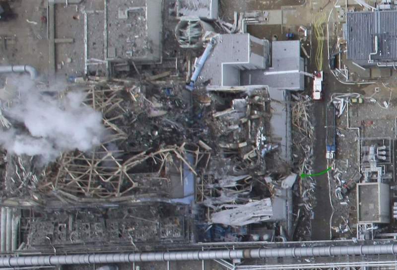

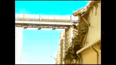

RE Unit 4 roof slice theory...
I've been following this thread closely since 2nd week or so, but have mainly kept my mouth shut as I struggle to comprehend the "science bits". However, as an architect I grasp the "construction bits" reasonably well (thankfully!)
I have however been bowled over by the minds (an due thought processes) of several forum members here. Thank you for providing an insight into the Fukushima situation for me.
I have serious doubts that anything fell onto the roof of unit 4 or sliced through it. The north side of unit 4 is seriously out of shape. It is bulging out around the service deck level significantly. Together with dislocated columns and beams to the top-most NE corner, may I suggest that what we see in the photos is a structure that came within a hair's-breadth of looking like it's neighbour, unit 3. I shall attempt to find a photo and overlay a straight line tomorrow if I have time.)
As the main north wall ballooned outwards, its (possibly un-restrained) top has caved inwards, buckling the steel roof cross-bracing in the NW corner. Whether this significant blast removed the cross-bracing from the rest of that roof bay or it simply collapsed under the roof covering I haven't looked at in detail yet.
(Having now been able to look over the Oyster Creek constructional drawings -many thanks for the links - it is clear that large conduit voids, general services penetrations,varying wall masses etc would have a great effect on how the energy from any explosion would be channeled throughout any given level of the building.)
Commercial roof structures/coverings such as initially apparent in these reactor buildings tend to be corrugated uluminium (aluminum for USA folks:smile:) or steel sheets. These are what we can see scattered all around. They are fixed together with just enough bolts/nails to prevent uplift from the negative pressure above the building from gales. On top of these (as TCups has correctly researched) is typically a lightweight foam topped with approx 2-10mm of built-up waterproofing layers (usually rubber, bitumen or plastic based).
I've seen quite a few cases of building/roof failure, and would suggest that such a roof as discussed here would have neither the mass nor the rigidity to slice through/impact/bend the heavily reinforced concrete wall frame of unit 4.
Also to be discounted is any other flying debris (from unit 3). I'm pretty certain that one of the main posters on this forum has already posted an image of unit 3 post-BOOM, with unit 4 apparently intact. I shall try to dig it out and attach here too.
Sorry I've not gone into more depth just here - its not far from midnight and I've had a chaotic day of chasing my wee boy around, nappy (diaper) changing and general mayhem.
ps. The other good thing about following all the posts on this thread is that I've saved a fortune by not frequenting a certain on-line auction site over the past weeks, and am now in my wife's good books :smile:
