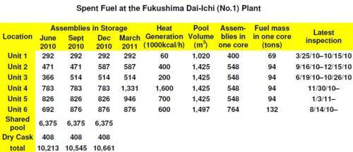

In summary, so far, here are some things to ponder. Thanks to all earlier contributors. Please correct any mistakes I may have made.
Many years of spent fuel rods were stored in spent fuel pools (SFP) both in the 6 reactor buildings and in a 7th pool on site. The SFP's are lined with steel and encased in very thick concrete walls.
The SPF's are engineered so that there is no plumbing or drainage in the bottom of the pools to minimize the possibility of leakage, which would be catastrophic.
[PLAIN]http://nei.cachefly.net/static/images/BWR_illustration.jpg
Unlike the reactor vessels which are engineered with multiple, redundant cooling systems, the SFP's don't have the same multiple systems, and consequently the same options to potentially pump seawater into them in an emergency. Dose levels near the top railing of an uncovered pool would be lethal in less than a minute.
While reactor units 4, 5, and 6 were in cold shutdown, only the fuel rod assemblies (which were not completely spent or used up) from the #4 Unit had been removed from the reactor vessel and placed in the SFP, so, both spent and unspent fuel rod assemblies and therefore, a much larger heat load was present in the SFP of unit 4.
Explosions, probably from hydrogen, occurred in units 1, 2, 3, and 4. The hydrogen gas is a byproduct from a reaction of oxidizing zirconium casings from hot fuel rods and steam. Again, no fuel rods were inside the reactor core and primary containment of unit 4.

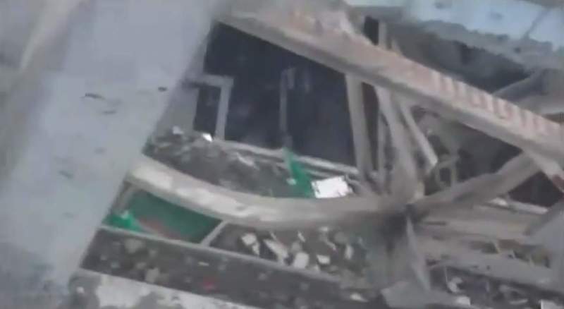

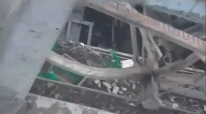

TCups said:
What first looked like this at unit 4 (again, with no fuel in the reactor core):
now looks like this:
Reactor 4.
  • #467
Astronuc said:
The top photo is the north face of Unit 4 toward Unit 3. The bottom photo is the south face of Unit 4. They are two different sides of the same unit.
That is true. We concluded and discussed that earlier. As well as the probability that there are variations in the actual construction at the units and some of the schematics on line. And also concluded, I believe, that there are pools on both sides of the reactor -- one for fuel rod assemblies, and another for equipment that comes off the top of the reactor core, and that the overhead crane (and possibly the fuel handling machinery?) can move back and forth.
If that is insulation, then more of the insulation seems to be cascading down the side of the building now, and additional thermal damage has been done to the north face, the side closest to unit 3, above the site of the original square hole.
I don't know for sure what is happening inside the Unit 4 building, but it isn't good and it is still going on.

Thank you very much for the diagram of the SFP.
In meters I guestimate it to 14x14x12 meters = 2352 m3.
Lets say that 153 m3 is taken by fuelrods. Or even 352 m3.
Then there is still 2000 m3 water missing if the pool is dry. That is 2000 tons.
The dousingattempt #1 by firetrucks sprayed 30 tons of water.
The dousingattempt #2 by firetrucks sprayed 50 tons of water.
Lets say that 1/3 made it to the pool. No, let's be generous, let's say that 80% made it to the SFP. 80% og 80 tons = 64 tons = 64 m3.
That means that the pool still lacks 1936 m3 water...
Or let's calculate another way around.
64 m3 water, delivered to a surface of 14x12 meters (168 m2) = a rise in waterlevel of 38 centimeters.
Can someone here please tripplecheck my calculations and tell me that I am way off - or please redo my math and add the boil-off rate from the fuel-rods, and begin to tell people in Japan to evacuate?
Math is your friend.

I don't believe I used the word "doomsday" or suggested lethal or near lethal radiation levels anywhere other than at the top rail of a dry SFP
The direct comparison of the north face of unit 4 is this
http://i306.photobucket.com/albums/nn270/tcups/r735227_5964756.jpg
versus this
https://www.physicsforums.com/attachment.php?attachmentid=33222&d=1300451324
Can we agree that something very bad happened inside of Unit 4 in the absence of an an operating reactor, and that the damage, to me at least, seems much greater than might conceivably occur from a fire from generator oil? Might that fire or whatever it was contribute to the accelerated loss of water in the SFP? Does anyone here even know, with certainty, where the precise location of the SFP is in relationship to the building's exterior?

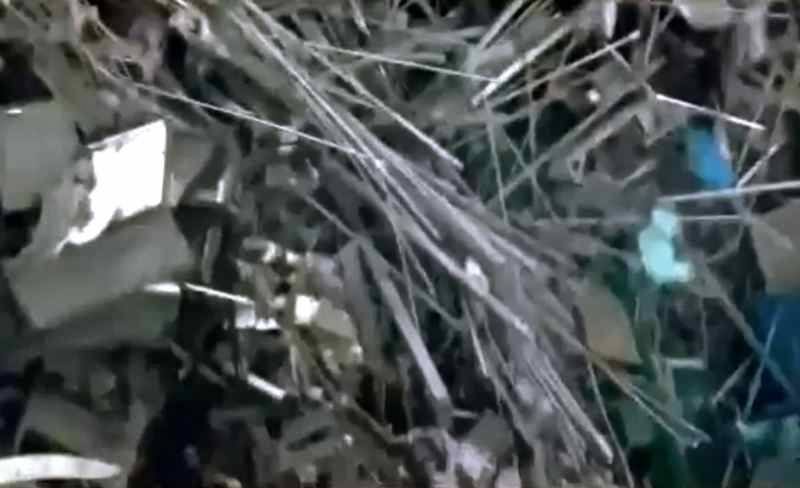

  • #471
Let's try and keep baseless speculation out of this thread. This thread has been the "cleanest" and most fact based discussion regarding this disaster that I have found so far.
Between the photo and the video they have dropped water via helicopter and have been using firefighting vehicles to spray water, and since this hole is quite low on the building it is not unfeasible that water that did not hit the pool flowed out through it dragging debris and dirt with it.
EDIT: Sorry for the poor quoting, the baseless speculation comment was aimed generally at this thread.

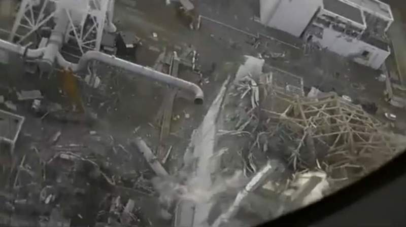

The problem is that we don't know the exact status of the SFP in any of the units, and until we see pictures, or someone publishes a reliable measure of the depth of water in the pools.
We also don't know the exact status of the fuel and cores of units 1, 2, and 3. For now, in the absence of direct evidence, we can only look from the outside of the damaged reactor buildings at the damage and ask - what would have caused that? Well - we did see explosions, fires, smoke or dust, and steam. The steam is obviously coming from boiled water, either in containment, SFP or both.
It may be the explosion of the containment of Unit 3 did most of the damage to Unit 4. Interestingly, the framework (girders and spans) of Unit 4 is still intact, although the panels got blown off. That indicates that if there was an explosion in Unit 4 upper containment, it wasn't so bad as to take out the framework. The panels are likely held on by metal screws.
Previously, there is a mention of 'melted' framework. I don't believe it is melted, but bulked or twisted (torsions), with large strains in some cases.
(One of my summer jobs during university was ironwork. I used to build metal buildings, and did the framework from floor to peak, and also did the sheet metal. I miss that!)
The smoke from Unit 4 could be burning oil or hyrdaulic fluid. It's not white, so it's probably not steam.
Each unit presents similarities, but is also a separate problem in and of itself.
  • #473
