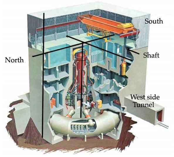

jensjakob said:
This is a real nice picture of a SFP, showing the door to the reactor compartment:
http://img.ibtimes.com/www/data/images/full/2011/03/17/75371-dd.jpg
So - can one of the problems in Fukushima be that this door is damaged, and that is why they can't keep the waterlevel up?
Does not make sense, since the picture show no gate in place and the water level is up? When in refueling mode the gate can be open or closed, but the reactor vessel water level is kept up (so gate is normally open) for shielding purposes.

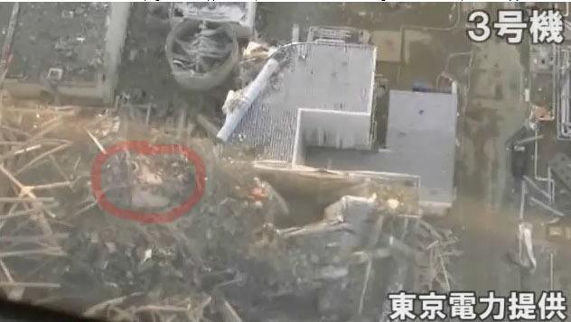

Astronuc said:
There is what the plant and utility have disclosed to officials, industrial and research institutions and media. Then there are officials, industry spokespersons, media and the consultants hired by those groups, or intervied in the media, and there is a mix of repeating the factual information (which could be wrong or misinterpreted) and speculation/conjecture.
Fortunately, being in the industry, I can pretty much tell when someone is bsing, or just wrong. I also know many folks within the industry in the US and abroad.
On Wednesday U.S. Nuclear Regulatory Commission Chairman Gregory Jaczko stated at a congressional hearing in Washington:
''Now, in addition to the three reactors that were operating at the time of the incident, a fourth reactor is also right now under concern. This reactor was shut down at the time of the earthquake. What we believe at this time is that there has been a hydrogen explosion in this unit due to an uncovering of the fuel in the fuel pool.
We believe that secondary containment has been destroyed and there is no water in the spent-fuel pool. And we believe that radiation levels are extremely high, which could possibly impact the ability to take corrective measures.''
http://www.nrc.gov/about-nrc/organi...-gregory-jaczko/0317nrc-transcript-jaczko.pdf
As an official, perhaps the basis for Chairman Jaczko's statement was information from TEPCO staff. According to a Wednesday noon EDT report in http://www.chron.com/disp/story.mpl/ap/world/7475743.html

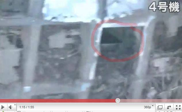

begin qoute -- Emergency workers ... resumed work after radiation levels dropped, but much of the monitoring equipment in the plant is inoperable, complicating efforts to assess the situation. "We are afraid that the water level at unit 4 is the lowest," said Hikaru Kuroda, facilities management official at Tokyo Electric Power Co. But he added, "Because we cannot get near it, the only way to monitor the situation is visually from far away." -- end quote
However, since Thursday TEPCO has been focussing visible efforts on dropping and shooting water onto the No3 reactor building to add water to the No3 SPF.
NHK TV reports of a helicopter video of the No4 building suggested that TEPCO officials had identified a patch of white seen at the edge of one of the rectangular black expanses framed by the remaining concrete frame of the south part of the east side of No4 was a reflection from water in the SPF. The video was similar or perhaps the same as the link in in a previous post
What degree of confidence could a plant operator or engineer put on identification of a blurred white dot appearing for a couple of seconds in a helicopter flyby as being an adequate level of water in an SPF?
Or is the reason for the re-prioritization of No3 over No4 more likely due to inability to get close enough to No4 to do anything effective, given the comments of Jaczko about radiation levels and the TEPCO facilities manager's comment?.

To all,
With that helicopter pilot risking and more than likely shortening his life, I have one question, WHERE ARE OUR PREDATOR UNMANNED DRONES WITH THEIR HIGH RESOLUTION 3 MILLION DOLLAR CAMERA'S. This is a no-brainer, at least for me, if ever they needed the technology, it was YESTERDAY ! There I feel better, having vented. Back to normal. Just had to vent, sorry.
Rhody...:redface: :confused: :rolleyes:

rhody said:
To all,
I don't think he was in any great danger (especially from radiation) other than that is normally associated with flying an apparatus that drops like a boiled egg when the rotors stop. You didn't see him flying directly over the units or through a steam cloud did you?
