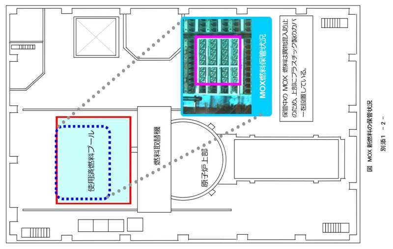

MadderDoc said:
I find there's a schematic floorplan of the service floor of unit 3 on page 28 in this pdf (see also attachment below, with the schematic tentatively x/y scaled):
http://www.pref.fukushima.jp/nuclear/info/pdf_files/100805-6.pdf​
https://www.physicsforums.com/attachment.php?attachmentid=34862&d=1303728878
Interesting notation on that image: "In order to keep foreign matter out of the stored MOX fuel, a plastic cover is placed over the top." Which makes me think of cphoenix's superheated water/steam explosion theory. If pumps stop, and there is a plastic lid over the assemblies, it sounds like his conditions could be satisfied:
https://www.physicsforums.com/showpost.php?p=3254513&postcount=4158
What is there about MOX fuel that requires that kind of protection, that doesn't apply to UO2 fuel?

Looking at unit 4, pink plastic seems there standard procedure when refueling regardless of mox .. that said the pdf seems to be discussing a lot about Mox.
rowmag might find answers within
  • #4,866
The PDF file is specifically a report on the condition of the long-term stored MOX at Unit 3, but that doesn't exclude the possibility that plastic covering is standard procedure regardless of the fuel. Have so far just skimmed the file, though.

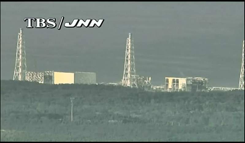

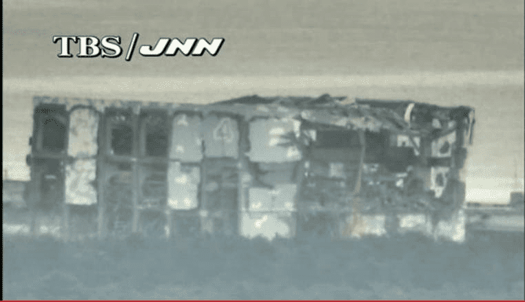

  • #4,873
Something very interesting I just discovered - apparently television images of the Unit 4 explosion / fire.
But it's hard to see anything...

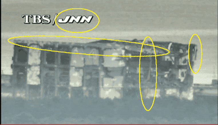

rowmag said:
I think it is a door. If you look really closely at biffvernon's picture, you can see the outlines of it on the right-hand side of the area that looks like a hole in other pictures. When it is open, it swings out to cover the left (as seen from the outside), so the square "hole" seen in other pictures is the combination of the inside of the open door and the interior of the building seen through the open door frame. <..>
I do think I see what you are pointing to, but I cannot quite make the suggested arrangement with an open door fit the apparent pre-explosion hole in the east wall of unit 4
Here is a zoom of biffvernons picture with the approximate extent of the 'hole area' marked up, and sided by a zoom from the original photo of the 'hole'. The markup has been done by looking at the blue and white pattern of the wall deco.

  • #4,889
To people drawing squares on the wall of Unit #4: beware that the floors inside do not have the same height. The 3nd floor is level with the roof of the building in front, and its ceiling is very low, just matching the height of the "hole". In the post-explosion pics, the "hole" is all but hidden behind a pile of rubble from the façade. the 4rd floor is slightly taller, the two rows of panels on the service floor (5th) taller still.http://www.ic.unicamp.br/~stolfi/EXPORT/projects/fukushima/povray/blueprint/un3_building_cut_N_2.png
Edit: fixed the floors above (3rd and 4th)
